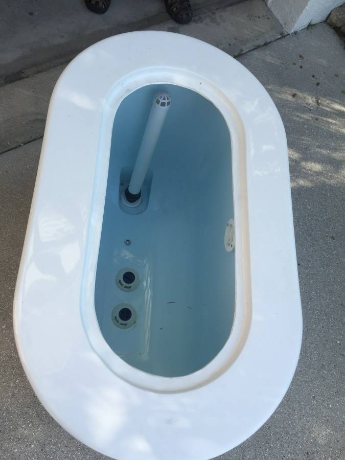

I have finally purchased a fiberglass livewell to replace pilot seat in my 1998 17 outrage. I will feed the livewell thru the small tunnel at the front of the fish box. I plan on using a bronze scoop strainer, a shut off valve, and a 1100-GPH Piranha-brand pump. The drain is my next hurdle to get over.
If I manage to put the drain in the floor of the fish box,I am not certain the livewell will drain properly. My plan is to replenish the water
in the livewell and get adequate draining.
The 17 OUTRAGE II had a option for a leaning post livewell. A picture of drain location might help my project. I have seen parts list schematics and there is not enough detail to help. The factory leaning post livewell does install the pump in the livewell, and there is a valve to change pump discharge to a raw water washdown.

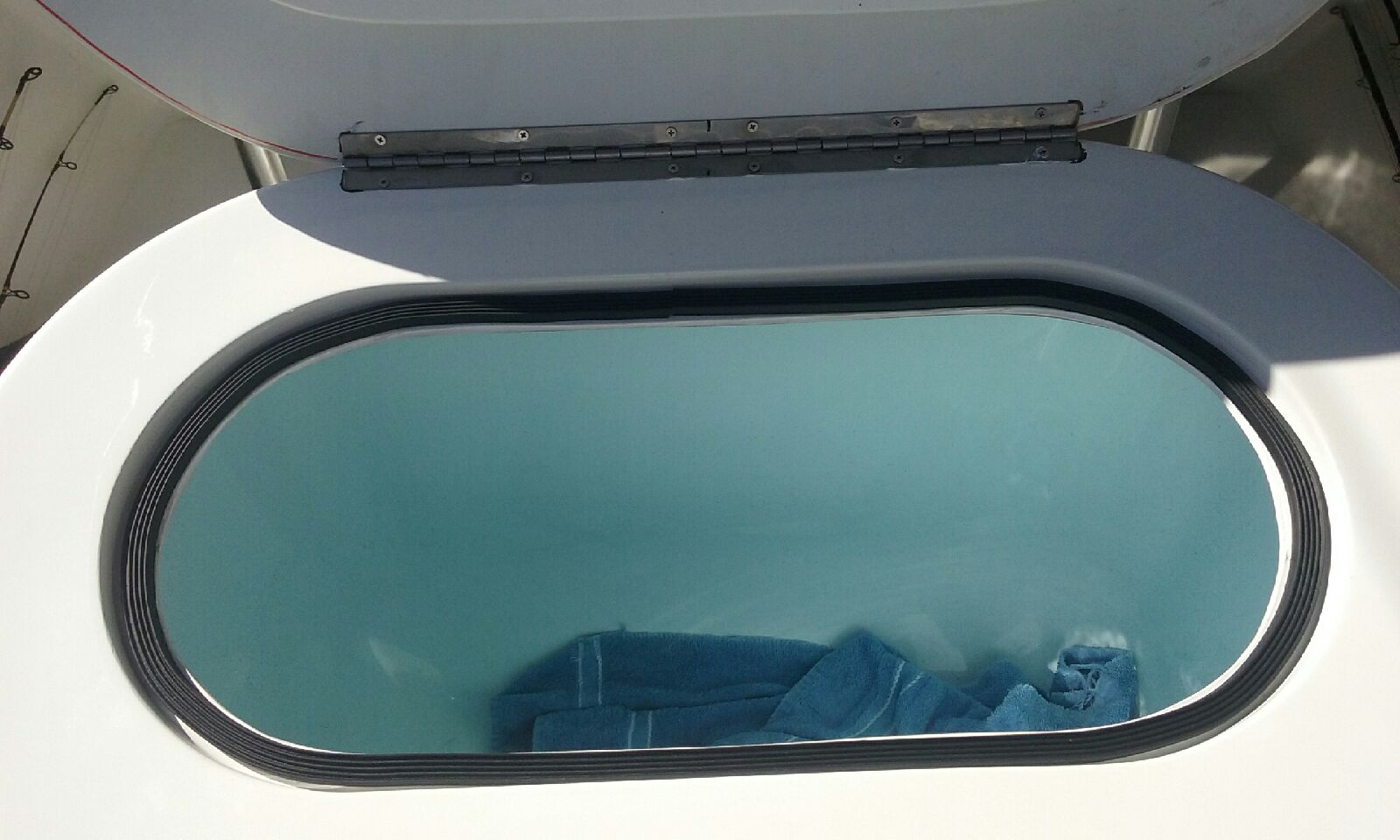

- new livewell with blue interior, drain pipe, dual feed,light

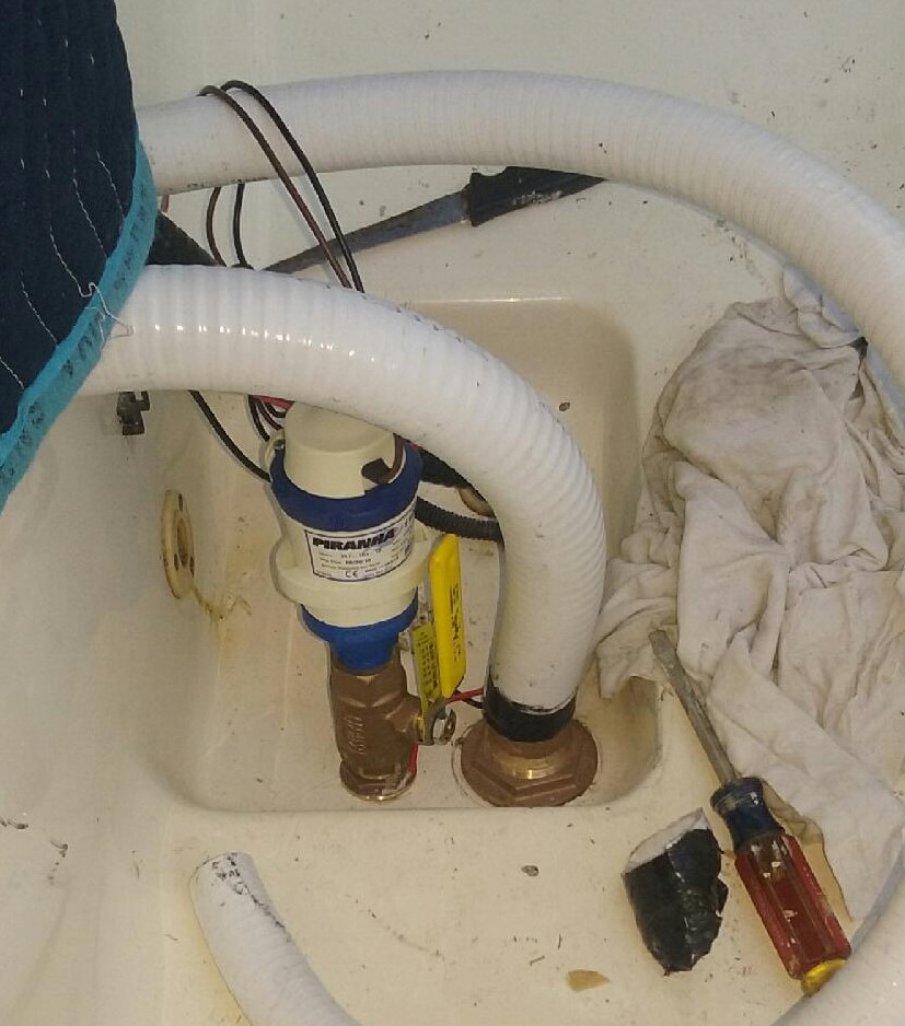

I have finished the install of a fiberglass 40 gallon livewell in my 1998 Outrage II.
I ran inch and a half hose for the drain and inch and a eighth hose for the feed with
a 1100 gph shurflo pump pushing the water.
I ended up installing a bronze drain thru-hull in the rear fish box along side the bilge
pump and the just behind the bronze scoop thru-hull.
My concern for the drain was not a concern. It can be drained fully with either the pickup
or the drain.
Other than the added weight, I am extremely satisfied with the baitwell.
