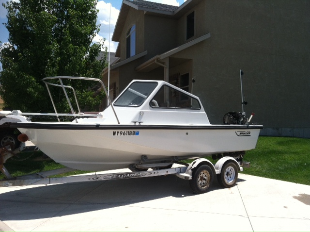

I have mostly finished the restoration on the 1995 Boston Whaler SENTRY 19. We took it out on July 3 and July 4, 2017. The [Mercury 150-HP OptiMax] engine would surge under 3000-RPM, and we only once got the boat on plane. After doing much googling, I narrowed down [the cause of the engine surging under 3,000-RPM] ] to either the tracking valve, fuel pump or pumps, or injectors.

Here is a pic of how the SENTRY 19 came out. Still a few trailer things to do but that's winter stuff.
