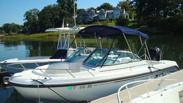

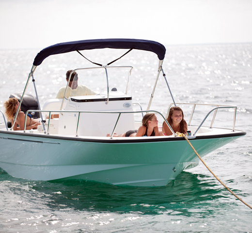

The Ventura 210 has a lot of bow rail to work with and it seems if the bow rail was cut in the middle you could split the bow rail and have it fabricated to drop-down and connect with the deck close to the front of the anchor locker:
Here is an image of the split bow rail factory option on the 210 Montauk:

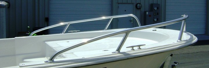

This bow rail was modified by a custom welding shop from a full bow rail to a split bow rail (non-BW boat):

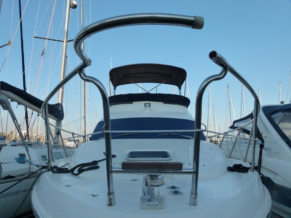

This is a typical hinged bow rail (non-BW boat):
Because of the large unsupported length of your bow rail, I would be inclined to fabricating a split bow rail, it would create a very strong hand-hold in the bow. Adding a hinge in such a large unsupported length of railing could create problems with the ability of the railing to provide structural support if a person were to need it in case of an emergency.

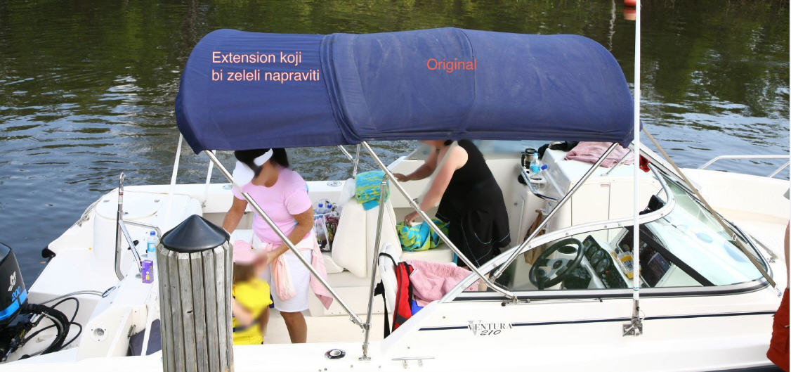

Last question - we would like to extend our back Bimini top to cover the back of the boat to protect us from the sun. Here is how it was done on a Ventura we would like to do like this:
Does anyone have experience with this company providing the extension?

Pred--there have been discussions regarding [RNR MARINE] and their various products. Decent quality, not inexpensive.
You have the right plan. Add a zipper to the existing bimini and add a second part with associated rails.
Given you are in the EU, I would take the photo and go to a local canvas fabricator.

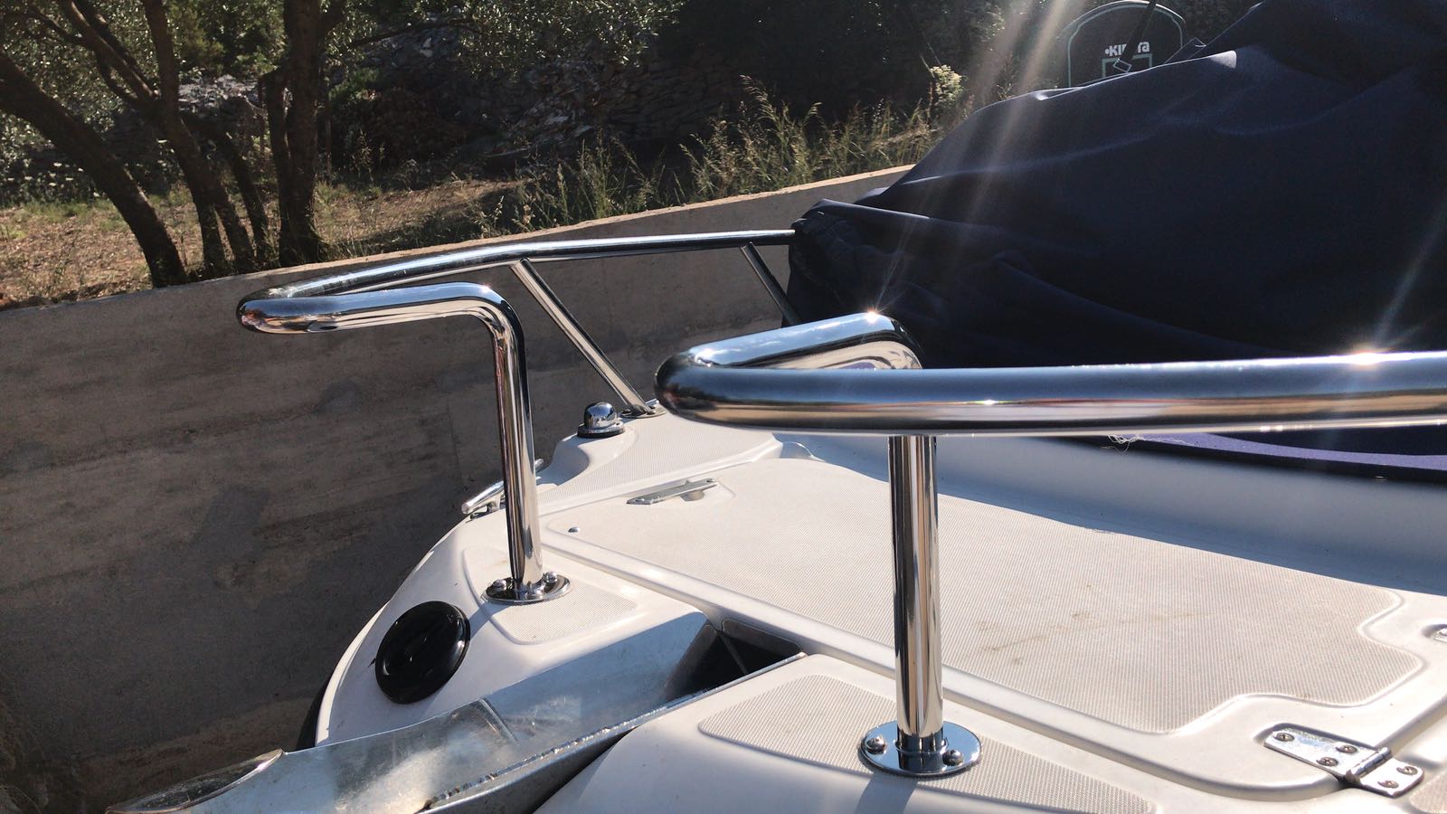

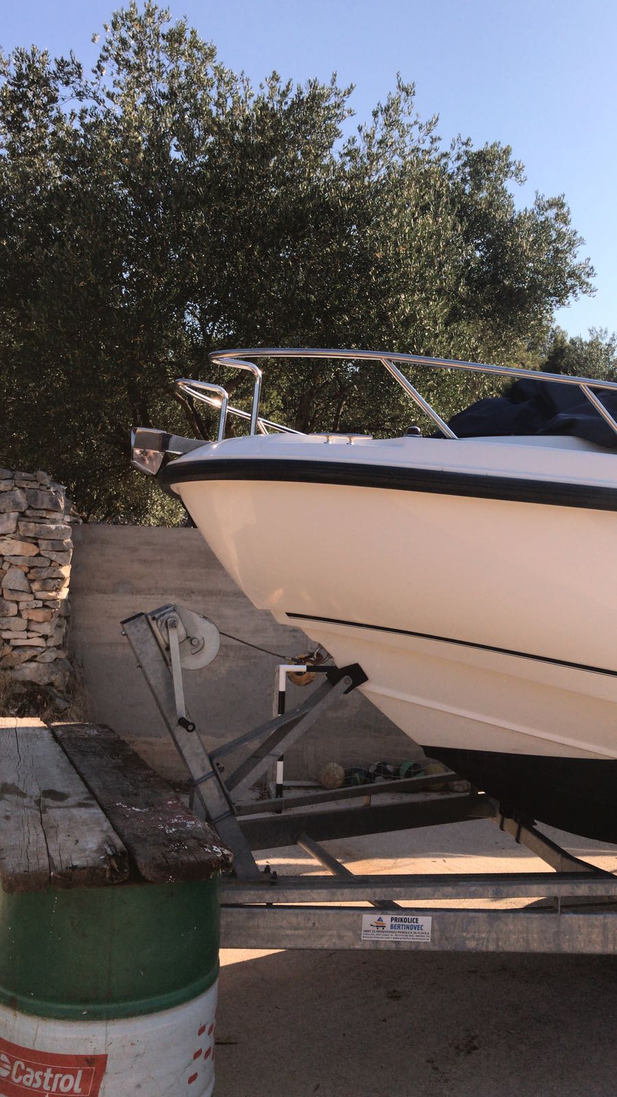

Re: Ventura 210 bow rail modification and toilet removal
- 897C27B5-45AC-4A96-8B7E-C6562ECBD539.jpeg (195.64 KiB) Viewed 9235 times
That is well done, Just like Ridge Runner described.
Great work!!!
