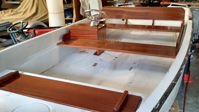

I used Sapele on my 13 and couldn't be happier with the look, the grain looks superb imo and much better than the mahogany I had originally tried restoring.
- IMG-20170522-WA0000.jpg (208.78 KiB) Viewed 10681 times

Wow that does look good love the grain pattern.
