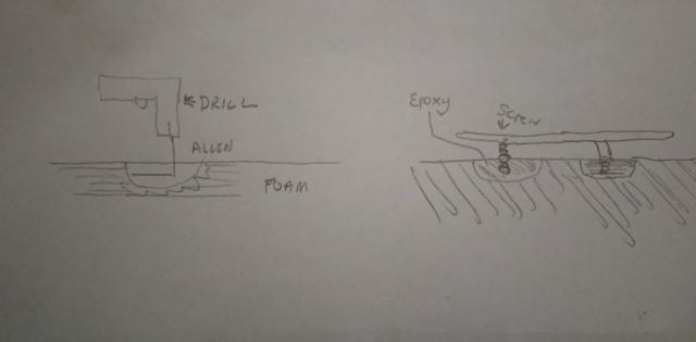

I learned this from a CW veteran and used it several times.
When adding a screw in a location without backing material, additional support is warranted.
In a foam filled hull, one method to add support is as follows:
Position cleat , mark holes for screws.
Remove cleat. Drill 3/8 holes.
Insert short end of allen wrench in drill. Insert long end into hole and use slow speed
Suck out any foam pieces.
Tape off area to protect gelcoat.
Squirt Gorilla Glue (expanding epoxy) into holes. Wipe off excess. Let cure.
Retap holes for screws.
Rough sketch:

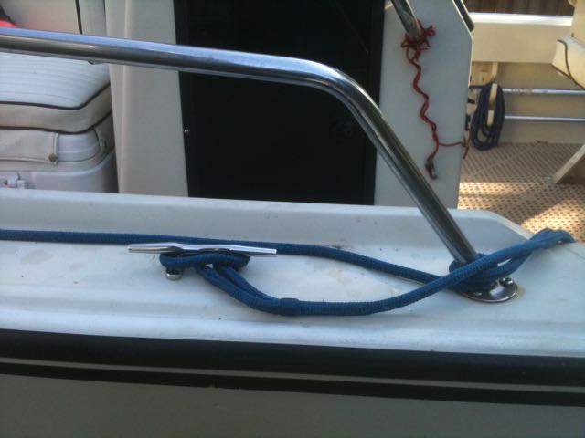

As for spring line cleats I'm very happy with the retractable ones I put in my gunwale. I did know where there was wood backing as shown on the schematics found on the owners resources of the Boston Whaler website (or here maybe on this site)
It is nice to be able to put them down when not in use and also nice for fender tie off when not always using a spring-line.
