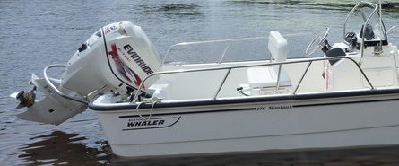

I have the factory tow arch on my 210 Montauk - I think the biggest concern with a putting a tow arch on a classic Montauk is that there will be no place with backing to bolt the tow arch to the deck. I think a turboswing is also the best option.
This turboswing status update was just posted: viewtopic.php?f=4&t=3744
I have had a turboswing on my 170 Montauk for eight years and it has performed far above expectations:
17 Whaler.jpg (24.1 KiB) Viewed 7565 times
