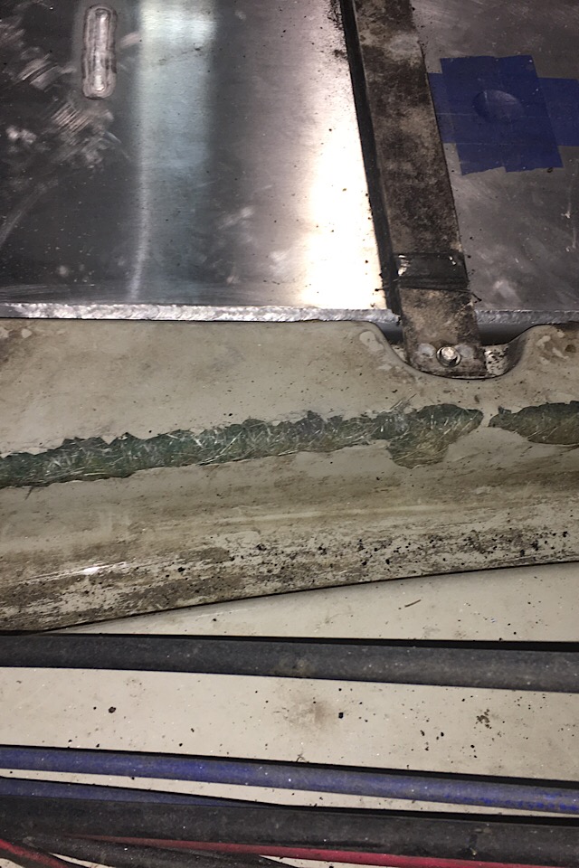

The only fault was an apparent factory defect. On the top lip of the rigging tunnel, there was a section maybe 8” ling without gelcoat, and the exposed chopped glass had almost no resin. Looks like during the hull layup Whaler missed a spot. Luckily being on the top lip of the tunnel, there was no standing water. There was some water intrusion into the foam, do the shop ground out the bad glass, removed the bad foam, reformed and reglassed the area. Sorry no pictures.

I found the pic the shop took when they lifted the deck off of my 18 Outrage.
