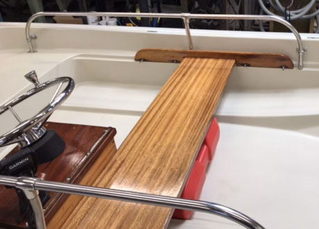

Postby Renaveg » Sun Apr 05, 2020 7:42 pm
I also have a 1979 SPORT 11. I mounted a [ SEPTRE Model 10506 3-gallon red fuel tank, 19.3 x 12.2 x 6.8-inches LWH and sold by Bass Pro Shops, shown below] under the center thwart seat. I had to raise the thwart seat 3/4-inch in order to fit the tank. This worked out perfectly, and I didn’t lose any floor space.
Fig. 1. Cockpit of 11-footer showing location of the fuel tank under the thwart seat.
