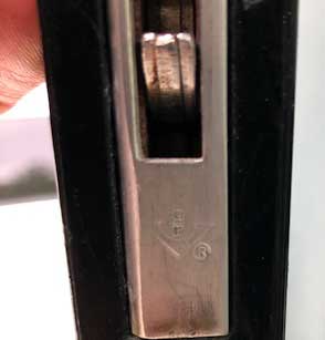

Fig. 1. Extreme close up view of door latch mechanism showing logotype of manufacturer. See text in article for futher details.
Who is the manufacturer of the door latch on the sliding glass door used on a FRONTIER 25 as illustrated above in Figure 1? There are markings of a lower case "a" and "r" with an inverted triangle. A call to Brunswick didn't yield much info since the notes on the Frontier are sparse.

Might be easier to identify if you remove it from the door and post a picture. A locksmith can probably identify the marks or recommend a replacement for you.

I would remove the assembly and consult a door hardware supplier. There are catalogs of the various options.

I took the latch apart and lo and behold the name was right there. Adams Rite MFG Co. HE87 was the model number. Thank you all for the input.
