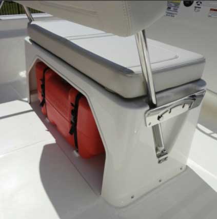

[Moderator's note: this thread has been moved to THE GAM for discussion. The thread was originally posted to MARKETPLACE. The MARKETPLACE is only for posting notices of FOR-SALE or WANTED TO BUY, and it is specifically NOT for soliciting discussions. This thread has been edited to remove six posts which sought out more information about the object that was being discussed, and all the additional information solicited has been incorporated into the original post as the original question with the information provided to enable it to be answered by readers.]
[Imputed question: Give me a source of a fiberglass molded aftermarket swing-back bench seat that is tall enough and wide enough and deep enough so that a SCEPTER on-deck 12-gallon fuel tank of rough dimensions 23 x 14 x 14-inches will fit under the seat, and the seat will fit properly in the cockpit of a SPORT 15]
BACKSTORY: I have a 1977 SPORT 15 [that apparently is to be modified to have a] center console.

Fig. 1. A seat that exemplifies the characteristics for the seat being sought for use in the SPORT 15 boat.

Note the 15 Sport has a very small area of flat deck where the console goes due to the hull design. I would measure the area and make a template to determine how large the console footprint can be. Compare the measurements to the Todd item.
You cut the back wall and install moulding on the cut line for a finished look.

Wise makes a seat that should work, Swingback, Model # 8WD155P, I have one on my custom 1997 16, I have 2 12-gallon plastic fuel tanks under it.
https://wiseseats.com/products/8wd155p-offshore-swingback-seat-frame

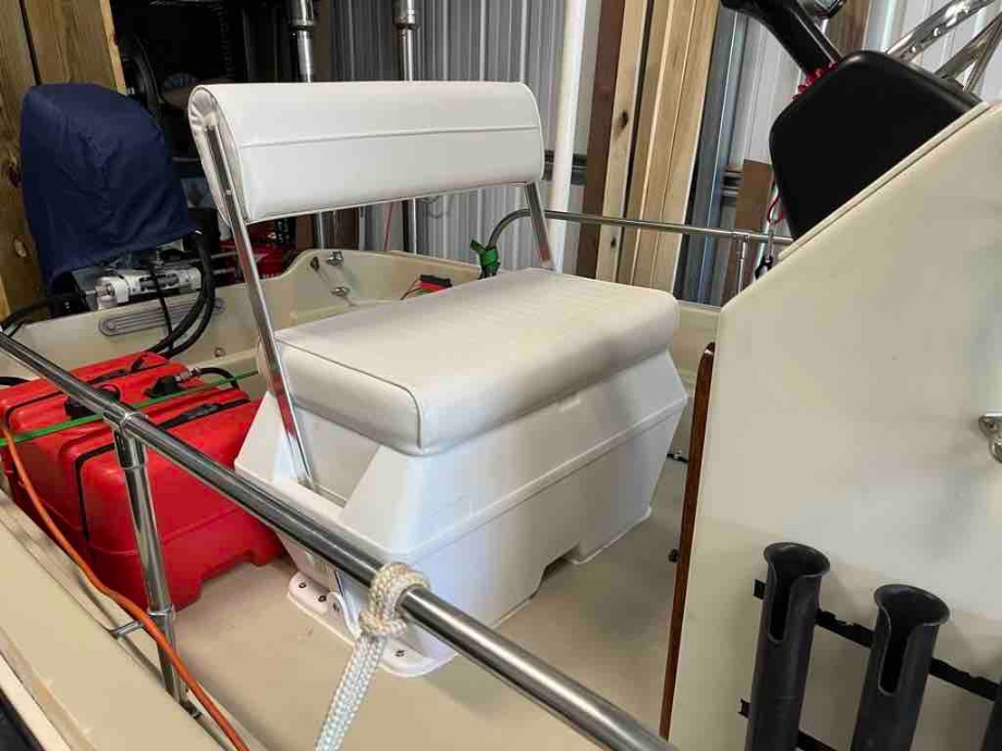

Postby Kapharms » Wed Nov 29, 2023 7:50 am
A bit delayed in posting the picture. Many thanks for the suggestions. The Wise-brand seat was a perfect addition to my SPORT 15.
Fig. 2. A seat made by Wise installed on a SPORT 15.
