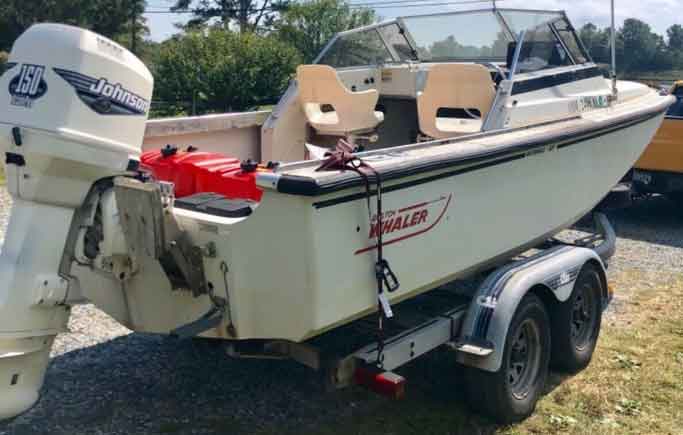

I do not have the Revenge on the new trailer yet.
Fig. 1. The trailer under discussion.
I've mounted the twin keel rollers at the mid cross section and a single at the rear cross section. The bunks just look too low where they are now. I've pushed them outwards away from the keel centre line and they will only be about 8-inches above the keel rollers. They will fit on the outside of the first hull chines about 21-inches from the keel.

I think if you do some measuring, you will find the hull will sit well. The chine will rest a few inches above and inside the fenders.
Fig. 2. Another Revenge 20 on a trailer for comparison.
