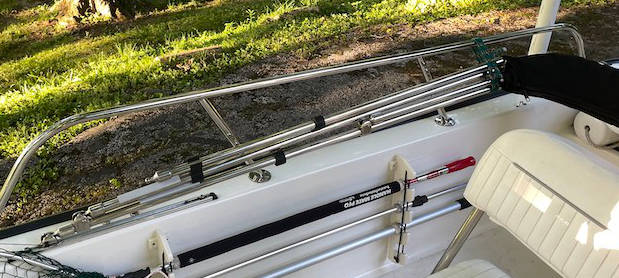

I recently purchased a 2014 Montauk 170. I was unclear how to fold down the Bimini top for highway travel, so I searched the forum for tips.
I expecting that folding down the Bimini top for highway travel to be something simple. I thought surely engineers had devised a simple solution to prevent the Bimini frame from flopping around--but apparently not yet.
In a five-year-old thread, I found other comments about the problem of folding down a Bimini top for highway travel, albeit on a 190 MONTAUK.
Below are several illustrations of a method for folding down the Bimini Top which may be helpful for 170 MONTAUK owners. My method may save others time and avoid hull and frame rail damage. I developed this method by my own tinkering.

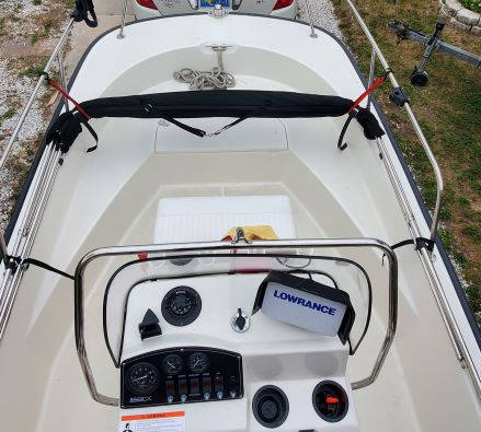

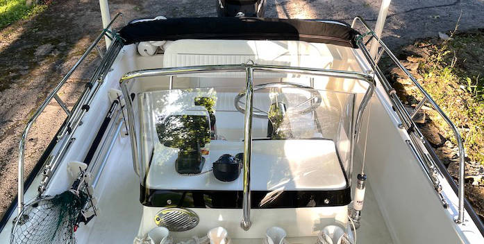

My method of folding down a Bimini top for highway travel on a 170 MONTAUK employs four two-feet-long cam straps and two 18-inch-long rubber bungee cords with hooks. [Cam straps are a type of hold-down strap that are only tightened by hand strength, and they can be released gradually.] The two-feet-long cam straps hold the poles of the Bimini top frame tightly together; the two 18-inch-long bungee cords with hooks provide a suspension [of the Bimini top frame from the bow railing]; this suspension keeps [the frame of the Bimini top] from rubbing and chattering on the gunwales.
Fig. 1. A view of the straps and bungie cords from overhead.
Fig. 2. A second view of straps seen from the side.
Fig. 3. Close-up of straps and bungie cords.
I hope publication of this method is helpful. If others have found a better way, please respond with details.
