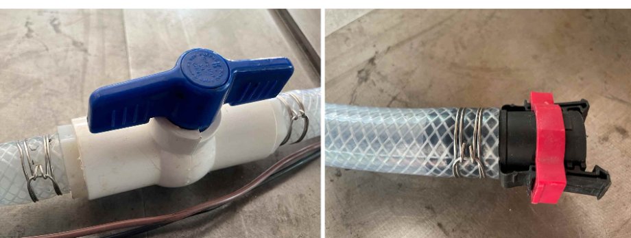

I was researching construction of a circulating livewell for my 1990 Montauk 17 when I ran across mention of a making hose clamps using a Clamptite tool (https://clamptitetools.com/). This is a device that exerts tension on loops of wire to form a clamp that gives uniform tension around a hose. The Clamptite company seems to market their tools to the automotive industry, although they do sell a marine version made of stainless steel and brass. I didn’t find any info on boat use on this or other marine forums that I belong to, but I thought I would give it a try. I was very happy with the results, as shown in Figure 1.
Figure 1. Wire hose clamps for livewell plumbing.
BW hose clamp 4.jpg (54.83 KiB) Viewed 3341 times

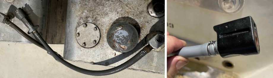

These wire clamps are corrosion resistant (I used 304 stainless steel safety wire, but 316 stainless steel wire and even Monel are available), are very secure, can be made in different sizes with the same tool and wire, and are inexpensive, as a one pound can of 0.041-inch 304 stainless wire costs about $20 and is enough to make over 100 clamps. They have a very low profile unlike worm gear hose clamps, which have metal tails that can snag or scratch boat occupants. In a small vessel like mine, this is an important consideration, so after using these wire clamps for a season on my livewell, I decided to convert all the connections on my above-deck fuel tanks from plastic zip ties to wire clamps. Here is how this turned out.
Figure 2. Fuel line hose connections using wire clamps.
BW hose clamp 7-12-23 5.jpg (51.13 KiB) Viewed 3341 times

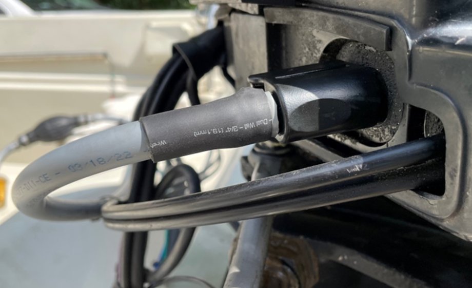

I was a bit concerned that the cut ends of the wire might snag something, but as long as the ends are firmly pressed into the hose, this doesn’t seem to be a problem. However, I did cover two of the clamps with adhesive-lined heat-shrink tubing. I think this is potentially advantageous, as the tubing makes a waterproof cover over the wire. Time will tell how durable this cover is.
Figure 3. Adhesive-lined heat shrink cover installed over wire clamp.
BW hose clamp 7-12-23 6..jpg (65.68 KiB) Viewed 3341 times
