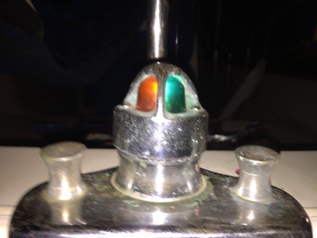

I am preparing to make my annual Gulf Coast pilgrimage this coming Saturday., I discovered last night the new socket I installed only a two years ago has corroded badly. Thought I had the housing sealed but saltwater got in, again. If the replacements will work I'd like to give them a try this time. Last time I was lucky enough to find an old OEM replacement but now it's probably either this or one of those cheap flashlight clamp-on lights jjust to get me through the trip.

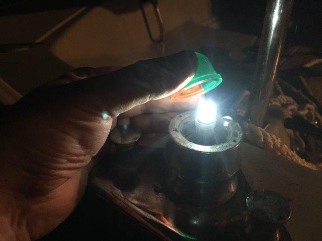

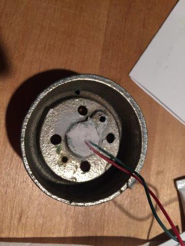

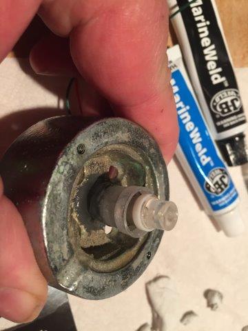

Postby Landlocked » Thu May 19, 2016 10:22 am

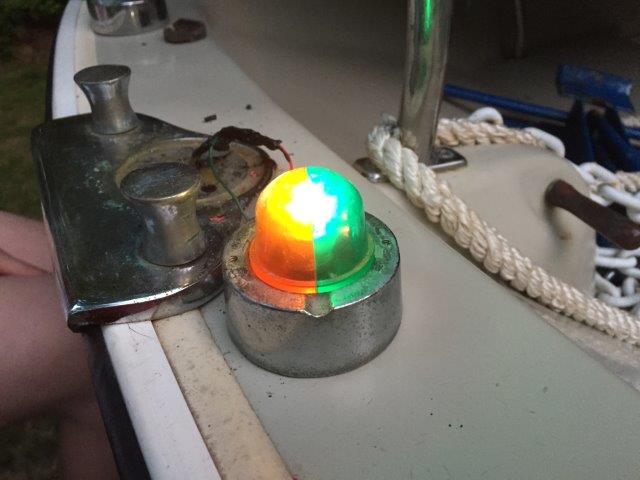

Light socket arrived last night. Does not fit hole in OEM base but given time remaining before my trip and lack of other options I elected to epoxy it on top. Would have been nice if it had fit as promised given price I paid for the light, socket and overnight shipping but I'm happy with the results now that it is installed. LED bulb is much brighter than the original conventional bulb.

Postby Landlocked » Thu May 19, 2016 10:25 am
Red-neck engineering at its finest but looks fine installed and may actually prove to last longer as the light is higher and bottom is sealed from water getting in from below.
