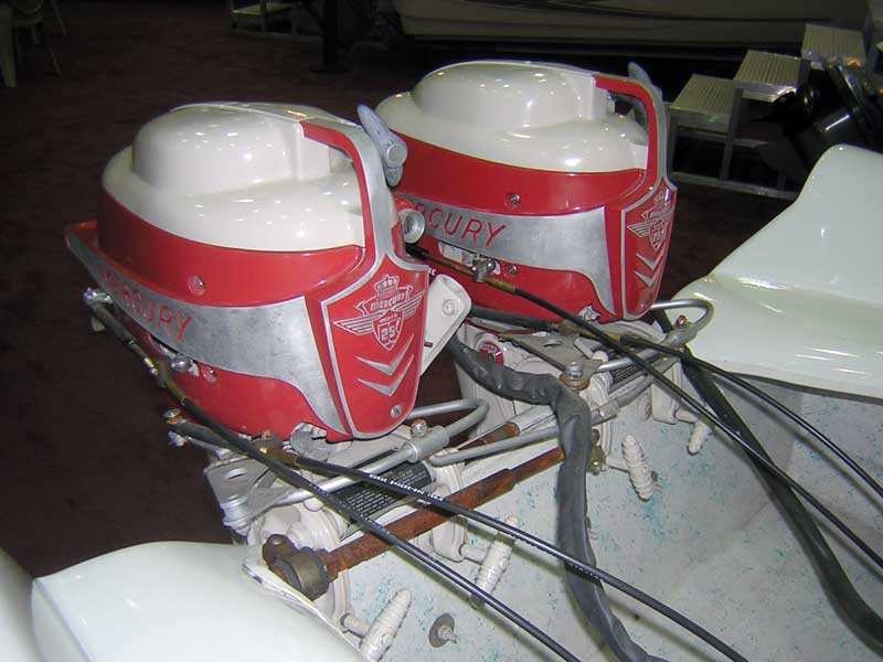

jimh posted 02-20-2006 01:44 AM ET (US)     Profile for jimh  Send Email to jimh
Using some confidential sources--the kind that only webmasters have access to--I have obtained these rare pictures of Castor and Pollux's grandparents:
http://continuouswave.com/whaler/images/castorPollux/LHG_Castor_Pollux. jpg

fourdfish posted 02-20-2006 10:54 AM ET (US)     Profile for fourdfish  Send Email to fourdfish
Wow Jim those are some oldies but goodies!
LHG posted 02-20-2006 12:11 PM ET (US)     Profile for LHG
Looking at those old Merc photos, steering and twin engine tie bars sure have come a long way.
