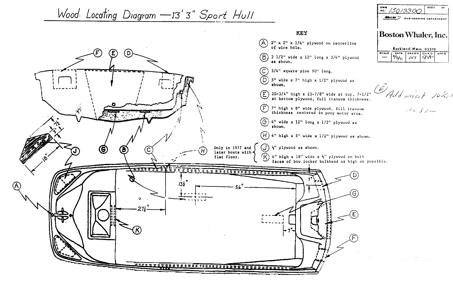

Embedded Wood
Because of the unusual construction, it was necessary to encapsulated hidden wood in the hull/liner composite to provide a suitable bed for attachment of fasteners. Three diagrams show the location of embedded wood in various models:
In the 1990's the wood was replaced with a synthetic "WhalerBoard" which provided a rot-free alternative.

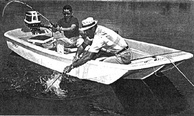

Photo: Whaler 13 c.1980 1970 Standard 13
Notice the shape at the bow: no smirk. This is the original hull mold. This catalog photograph shows a constant theme of the 13-footer: boys (big and small) fishing.

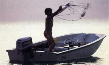

Photo: Whaler 13 and young boy fishg c.1980 Whaler 13 Sport
The Whaler 13 was often shown being used by young people without adult supervision. Here a young boy stands and casts his fishing net by himself at dusk, a situation in which, if you're the parent, you've got to have a lot of faith in the boat and the boy. Owning a Whaler encouraged both.

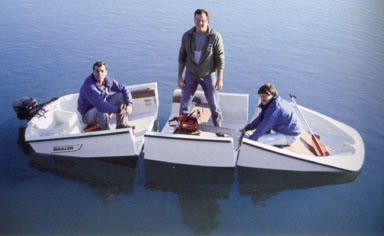

Photo: Whaler 13 Hull, cut into three pieces This 1999 catalog photograph reprises the famous George Silk Life magazine layout from May, 1961, which showed Dick Fisher (in a sport coat, bow tie and hat) yawning while his boat was cut in half by a huge saw. Advertising--as near genius as the boat itself--propelled Boston Whaler into public awareness far beyond just the boating crowd.

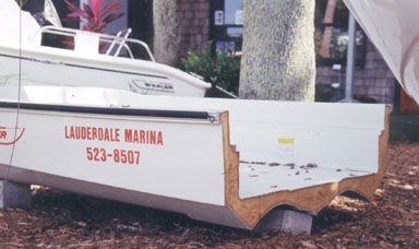

Photo: Whaler 13 Hull section Cutting Whaler hulls in half seems still to be a tradition. This Florida dealer has a 13-footer on display, nicely revealing the construction technique and the hull form.
