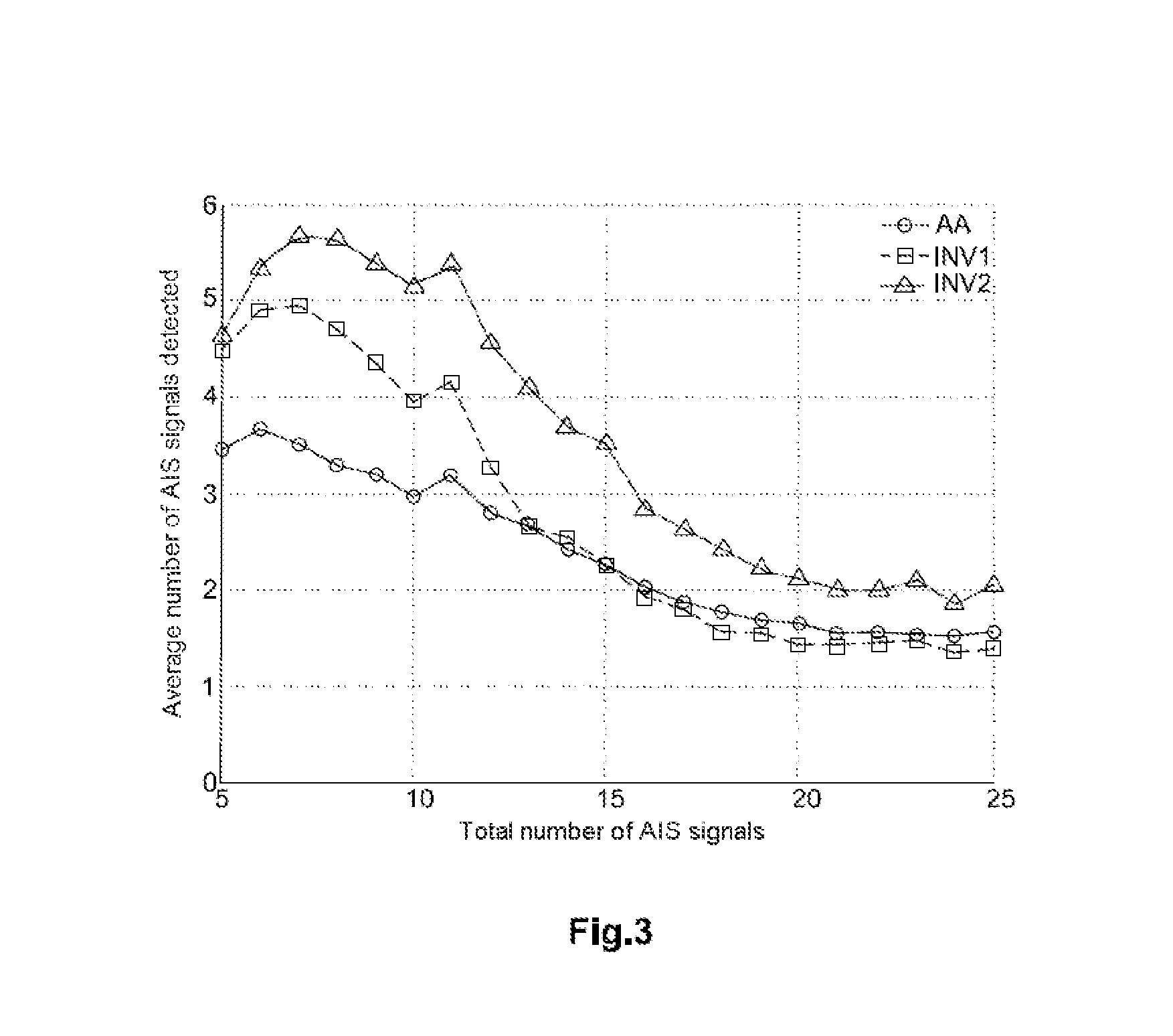

    FIG. 3 represents curves, obtained by simulation, illustrating AIS signal detection efficiency of several detection methods. More particularly, FIG. 3 represents the average number of AIS signals detected as a function of the total number of AIS signals present in individual signals, in the case of an antenna array 22 comprising five individual antennas 24 spaced apart by one wavelength, each of said individual antennas 24 having double linear polarization (horizontal and vertical).
    Three curves are represented, illustrating the results obtained for three different detection methods: one detection method according to the prior art and two detection methods according to the invention.
    For comparison purposes, the same total number of virtual beams formed was considered for the three detection methods, in order to obtain a substantially equivalent computation complexity. In the case in point, a total of 72 virtual beams were formed to obtain each of the curves represented in FIG. 3.
    In the detection method according to the prior art, twelve main directions of radiation were considered (from −30° to 25° in 5° steps) and, for each main direction of radiation, six different linear polarizations (from 0° to 150° in 30° steps) were also considered. The results obtained correspond to the curve designated “AA” in FIG. 3.
    The detection methods 50 according to the invention, considered to obtain the results represented in FIG. 3, both comprise four detection iterations and are both based on the estimation/suppression of the AIS signals detected in the individual signals, the individual signals obtained after suppression being considered for the forming of virtual beams during the next detection iteration.
    In the first detection method 50 according to the invention considered (for which the results obtained correspond to the curve designated “INV1”), the same virtual beams are formed during the four detection iterations. More particularly, six main directions of radiation (from −30° to 20° in 10° steps) and, for each main direction of radiation, three different linear polarizations (0°, 60°, 120°) were considered.
    In the second detection method 50 according to the invention considered (for which the results obtained correspond to the curve designated “INV2”), different virtual beams are formed during the four detection iterations. For each detection iteration, six main directions of radiation were considered and, for each main direction of radiation, three different linear polarizations were considered. More particularly, the following were considered:
    --during the first detection iteration: the main directions of radiation from −30° to 20° in 10° steps and, for each main direction of radiation, the linear polarizations 0°, 60° and 120°,
    --during the second detection iteration: the main directions of radiation from −25° to 25° in 10° steps and, for each main direction of radiation, the linear polarizations 0°, 60° and 120°,
    --during the third detection iteration: the main directions of radiation from −30° to 20° in 10° steps and, for each main direction of radiation, the linear polarizations 30°, 90° and 150°,
    --during the fourth detection iteration: the main directions of radiation from −25° to 25° in 10° steps and, for each main direction of radiation, the linear polarizations 30°, 90° and 150°.
