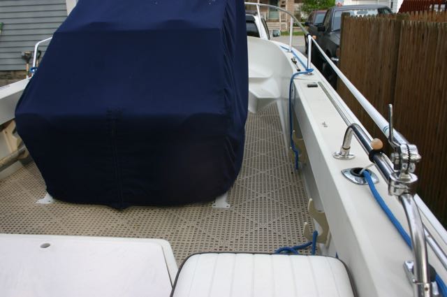

I used a few pieces of dri-dek in my anchor locker.
You can cut it if it suits your fancy. And I put a piece up the aft bulk head where the anchor contact it.

I use the 1-foot square pieces of Dri-Deak. I'm using them in the anchor locker, the forward bow compartment and the floor of the center console to allow some air circulation.

For installing Dri-Dek, you don't need a heat gun, rather a warm day on the driveway. If cold and stiff it will conform with some weight.
The beauty of Dri-Dek is the ability to easily shape it to the area you want.
