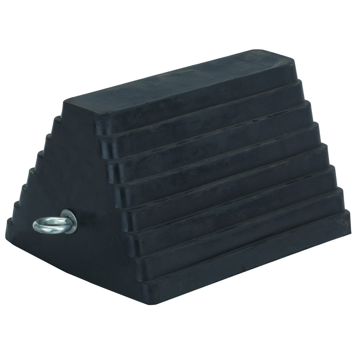

I use this chock: http://www.harborfreight.com/rubber-wheel-chock-with-eyebolt-69828.html.
It seems ideal for the chock on a rope setup (although the eyebolt is just zinc-plated so it will rust a bit) and I'd expect 2 of them to hold almost any vehicle.
The only downside is that those chocks reek when new, a really nasty, acrid rubber smell. My wife calls it "the Harbor Freight smell" since other rubber products they sell are the same. Plan to keep the chock outdoors for a while until it wears off.
