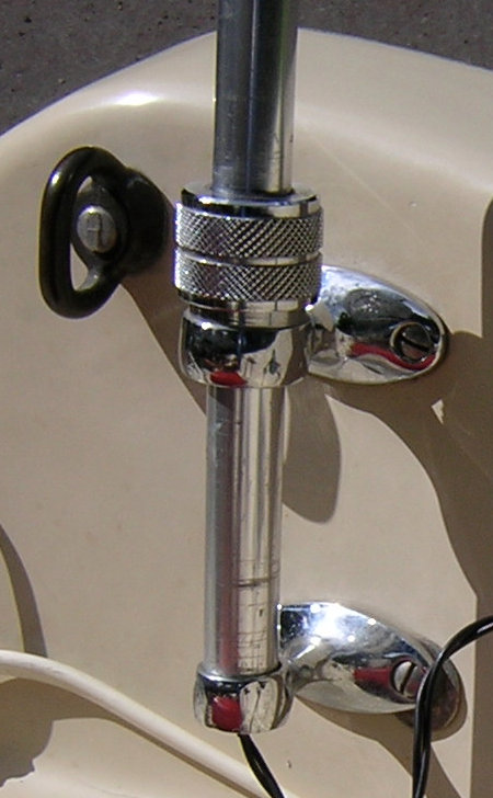

Also, the the lamp seen in Figure 1 appears to use the mounting method of having two circular mounting fixtures installed on the transom. This method is common on classic Boston Whaler small hulls.
Fig. 2. Pole lamp mounting detail as seen on older small Boston Whaler open hulls.
The ID of the circular mount is 7/8-inch, typically.
The only source for that exact OEM lamp will be from an older classic small hull. It would be unusual for an owner of an older 13-foot to want to sell just OEM the pole lamp from his boat.

MORE ABOUT OEM MOUNTING
The typical OEM mounting method on a smaller Boston Whaler uses two circular clamps. See Figure 2, above. Boston Whaler used that mounting because of the unique Unibond hull design. Normally a navigation pole lamp would be mounted to a socket fixture on the stern deck, and the wiring would be accessible under the deck. But on a Unibond small open hull, there is no access under the hull gunwales, so the lamp mount as shown in Figure 2 was always used.
