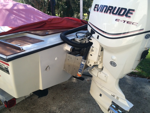

As the owner of the 18 Outrage with the Armstrong Bracket on Cetacea page 24, I can say that configuration served me quite well for many years. However, I have since (late 2012) changed my Whaler's setup. Needing to replace the 150hp Johnson OceanRunner (3,000+ hours), I opted to remove the fixed set-back of the Armstrong bracket and replace it with a hydraulic jack plate. The Jack Plate I installed is one that has a 12 inch setback and has an 8 inch range of vertical lift. This accompanied by my new (2012) 150hp Evinrude ETEC has proven to be a superior setup. The multiple combinations of vertical lift and engine tilt give me unlimited ride characteristics for just about any condition.

hauptjm wrote:As the owner of the 18 Outrage with the Armstrong Bracket on Cetacea page 24, I can say that configuration served me quite well for many years. However, I have since (late 2012) changed my Whaler's setup. Needing to replace the 150hp Johnson OceanRunner (3,000+ hours), I opted to remove the fixed set-back of the Armstrong bracket and replace it with a hydraulic jack plate. The Jack Plate I installed is one that has a 12 inch setback and has an 8 inch range of vertical lift. This accompanied by my new (2012) 150hp Evinrude ETEC has proven to be a superior setup. The multiple combinations of vertical lift and engine tilt give me unlimited ride characteristics for just about any condition.
Thank you for the first-hand feed back. Very nice boat your have, too!
Could you please tell us the brand and model of your hydraulic jack plate?
Also, with your hydraulic jack plate, do you still need to use a 25" shaft on your outboard engine? Or would a 20" shaft suffice given the amount of vertical adjustment the hydraulic jack plate affords?
If not too inconvenient, it would be nice to see some photos of your new arrangement. Thanks!

The Jack Plate is an Atlas Brand. I still have the Armstrong Bracket.
