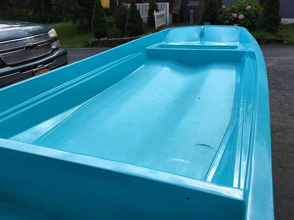

by akwalker
Two coats of Whaler Blue. Inside is drying in the sunshine. Came out really nice.
Re: Restoring c.1963 13-footer
Posted: Fri Aug 04, 2017 2:00 pm
by akwalker
Interior refinished and re installed.

by jeopardy954
Wow, looks great! That interior really sets it off!

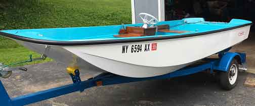

by akwalker
Well, she's as done as she's gonna be. Ready for a test ride.
Posted: Fri Aug 11, 2017 9:44 am
by Dutchman
Looking great she should be a lot of fun.
Posted: Sat Aug 19, 2017 9:10 am
by akwalker
Thanks. She even floats!!
