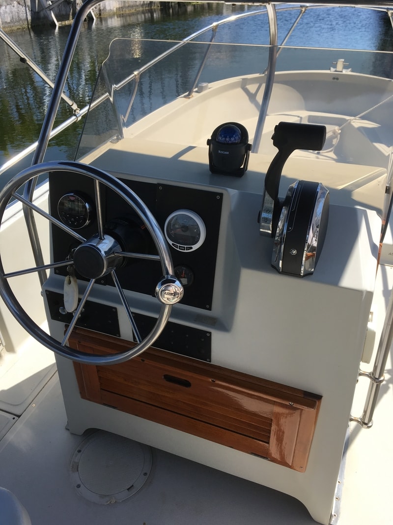

I was getting ready to order a console cover for my 1986 18 Outrage and it all of a sudden struck me that I may not have an original console. Below is a picture of what I have. Was this an original standard console, an optional console or from a larger Outrage?

You have the standard console.

RWM wrote:Was this an original standard console, an optional console?
The console you show is one of the last revisions of the standard size center console. It has a mounting pad for the engine shift and throttle controls that puts the top-mounting controls more or less at a level setting. Earlier versions had the mounting location for the controls on quite an angle. I think this version is the best--that's why it is the last revision.

I went to order a console cover from Mills and sent Suzanne the picture above just to make sure it would fit. After review of the picture she said the console cover would NOT fit. Apparently when the helm was replaced and Baystar hydraulic steering installed the wheel is now more vertical then original. Too bad, I wanted a nice cover from Mills. Also I don’t much care for the nearly vertical wheel...Bob

I enlarged your digital image and did some exposure compensation in order order to better see the helm mounting:
Helm installation on OUTRAGE console
While not completely clear, it looks like perhaps a wedge-shaped bezel has been used to give some tilt to the axis of the steering wheel, making the axis just about horizontal. If there is a bezel involved in mounting that helm pump, you could change the orientation of the bezel so it tilted the axis upward instead of downward. That would:
--get rid of your objection to the present orientation being too horizontal (or as you describe, too vertical), and
--perhaps better fit with the canvas pattern from Wm. J. Mills & Co.
Or, you could get a bezel without any bevel, mounting the helm just normal to the panel, as probably was more like the OEM installation.
A clearer image of the mounting of the helm pump would be useful to resolve the ambiguity.
Also, that is a nice six-spoke wheel, probably a GRANT MARINE product.
