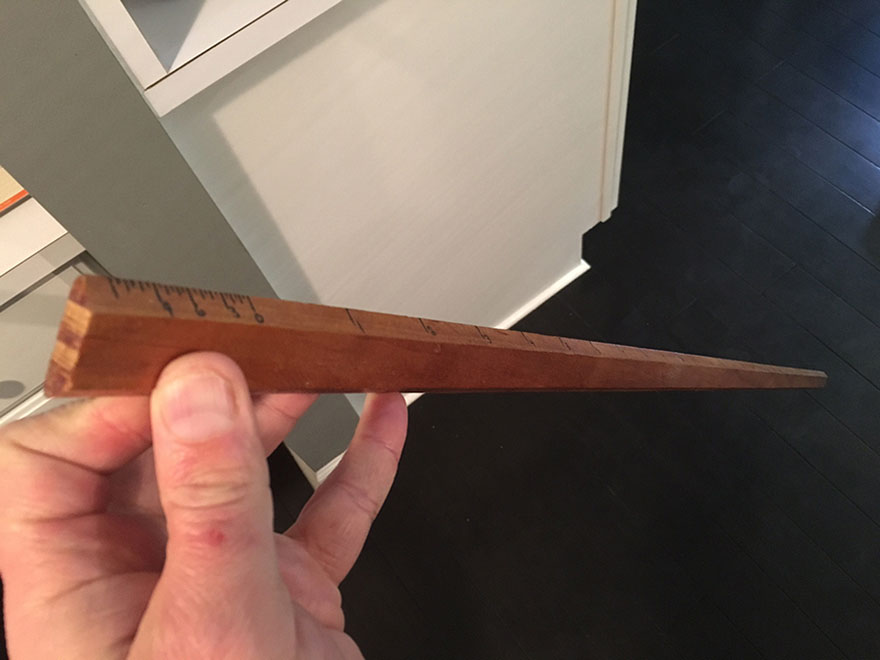

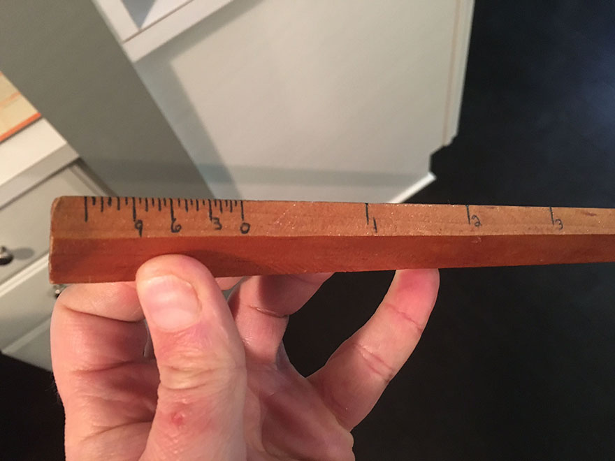

The story of how Dougherty Design the Classic Whalers is a helluva interesting one for me. You see, Bob Doughtery would hand sketch all of his designs and then create the wooden measuring scales to fit the drawing. This way if the drawings were ever to get in the hands of a competitor they would need the scale that corresponded to that drawing to get all the correct info. If you know architectural drafting this style is backwards. When you draw plans you are already working to a known scale. By sketching the design free of scale you are able to create a true free form aesthetic for the item you are trying to design.
This leads to one interesting item that I have. A number of years ago I bought one of only two scales that were saved from Boston Whaler. The scales were pulled out of the trash in the early 90's by Janis' (owner of Magic Brush) husband Tom Johnson (draftsman on the old CW site) around when he worked there. Tom told me when I bought this scale on ebay, at that the time management was literally throwing away all of Dougherty's hand drawings, hand made scales and other Classic Whaler design and engineering items. Tom, could only save the two scales without being noticed and he saved a few other things too. The rest of these scales are gone... Having attended the Center for Creative Studies where I studied product and transportation design, and always been drawing whalers as a kid, this scale is the most prised Whaler item I own.

By the way, I also have a Dougherty custom scale (thanks to Jeff). It has a very long scale, going out to 28-feet, so I assume it must have been used for the design of a larger boat, perhaps a 25-foot or 27-foot hull.

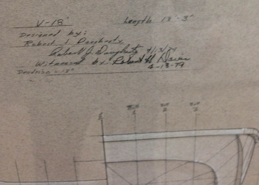

Attached here is the original photo. I had to carefully stretch and reform the image in multiple step to get this so to read as close to a true straight on elevations as I could. You can see from the shadows along the top edge of the matting, the paper does have a wave to it.
Also, here is a detail shot of the notes above the front elevation. Notice the design date of 4-13-1979, the deadrise called out at 18 degrees, and the hull was called the "V-18'"

It's interesting that the length on the drawing is indicated as 18' 3", which is 3" short of the Outrage 18 spec length of 18' 6". It could be the extra length was added by enlarging the "upper lip" of the smirk upwards and forward to create the production version. Doing so would have also flattened out the sheer line.
