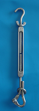

I have used a stainless steel cooler hold down kit available from Kennedy Products:
http://www.kennedymart.com/proddetail.php?prod=C00L1
I bed the deck base plates with 3M4200. I have used these with Igloo and Engel coolers. Here is the mount on an Engel cooler on my 170 Montauk:
The turnbuckle works very well and holder keeps the cooler fastened extremely tightly:

by Phil T
I admit the bungie cord/strap design has it's shortcomings and have experienced it first hand.
As some veterans might remember I had a habit of venturing out in nasty conditions and stuffing the bow of the boat. I recall at least 4 times when the cooler in my classic Montauk and Outrage 17 got knocked over or loose (handle broke). Keeping my tools and heavy gear in the cooler reduced this from occurring.
If one ventures out in the ocean into pounding waves, I would use RR's suggestion. Nice find!

by Sharkbait
Thanks for the pics RR - I doubt I'll be out in anything gnarly enough to warrant your very sturdy system. It's certainly got me thinking though! Jefecinco - don't worry I was always going to fit the pad eyes to the bracket and not the cooler - my limited imagination hadn't even got round to thinking of that option :)
