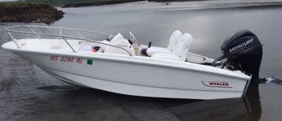

Fig. 1. 2017 130 SUPER SPORT
The seats I used are not folding seats.
They are comfortable and look [like the Boston Whaler seats].

Looks good. How did you mount them on the bench?
Re: 130 SUPER SPORT Seat for less than $700
Posted: Sat Mar 09, 2019 7:30 am
by 1stwhaler
The seat bottoms have a threaded insert. I made a [template], scribed the bench, drilled four holes for each seat, and through-bolted with stainless bolts. I did not like drilling holes in the bench, but I decided to go that route instead of fabricating some sort of bracket.
The [seats] are good quality and very comfortable.

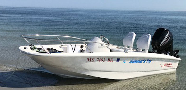

The Tempress seat [that is being recommended as an alternative to the Boston Whaler seat is shown at]:
https://tempress.com/store/Fishermans-Armless-Low-Back-Helm-Seat-p97903359
Fig. 2. A seat that is recommend (above).
