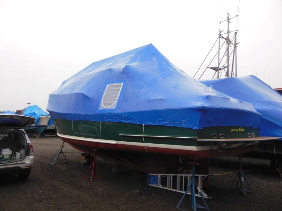

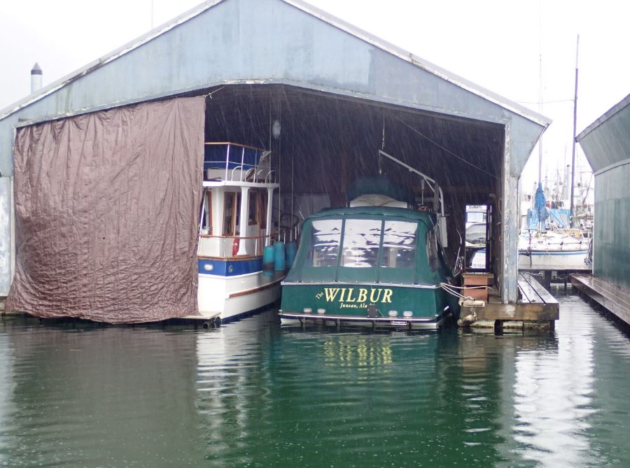

Winterization is almost another topic for the northern climates and The GAM. Tougher in remote areas where services may not be available.
"The WILBUR" under shrink wrap
"The WILBUR" option 2 boathouse saves money.

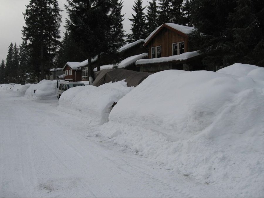

1990 Revenge 22 - W.T. "Kelsey J" under the brown tarp (Had her for 19 seasons.
Winterizing the "Kelsey J", my 1990 Revenge 22 - W.T. for 19 seasons, was fairly simple. To the shop to winterize the 225 Merc Optimax, and a day in the front yard to cover her. Leave air gaps in the cover to circulate air, no electricity needed.
A 34' boat is a bit tougher. If hauling for the winter, you have to get somebody to haul her to a boat yard as 17,000 pounds was too much for the truck ($940), then shrink wrap ($1,100), then pay for the yard (~$750), and electricity. I left her in the water last two winters and reused the shrink wrap (failure last winter, it blew off). This winter I'm renting a boat house ($1,700 for 6 months) and still paying for my regular slip.
