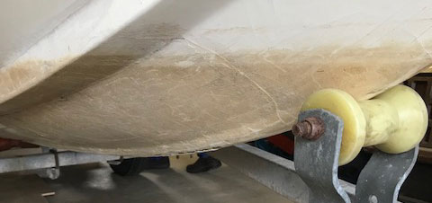

Fig. 1. Chip in the bow area above the water line. It looks the gel coat could be ripped off the hull.

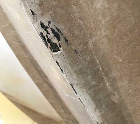

Fig. 2. Damage along the hull bottom.

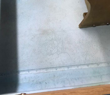

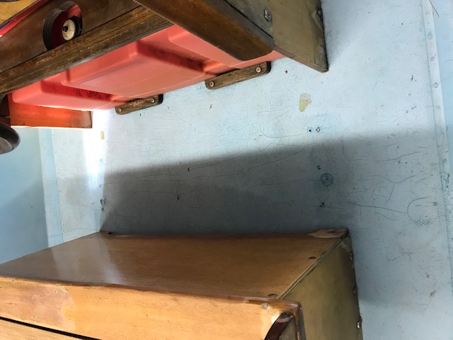

Fig. 3. General crazing of the deck on the non-skid.

Q2: Could the cracks in Figure 2 be a way for water to get into the foam?
Q3: Will the cracks in Figure 3 need to be repaired before the hull can be used?

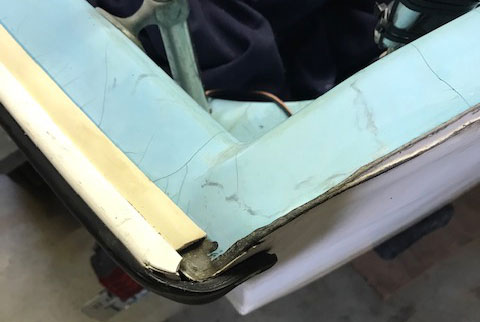

Fig. 4. General crazing of the hull bellow the water line.

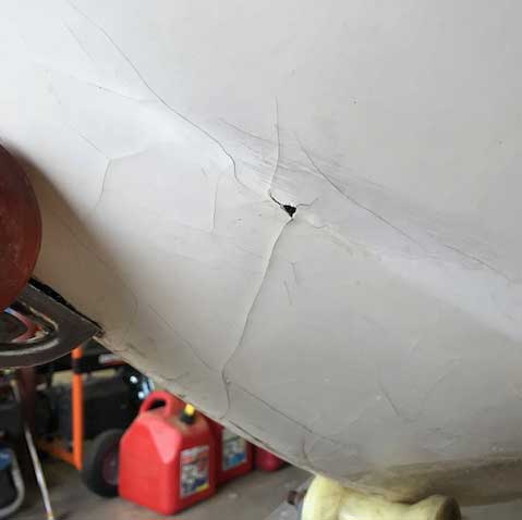

Fig. 5. Crack in the corner at the transom.

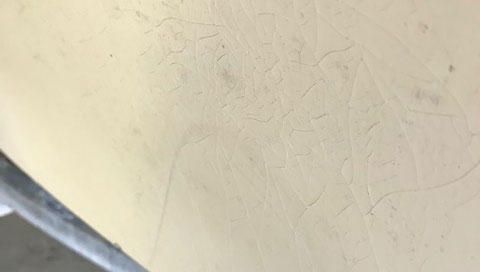

Fig. 6. Close-up view of crazing on hull side above water line.
Q4: Could water enter by the cracks in FIgure 4?
Q5: Could water enter by the cracks in Figure 5?

The damage shown in Figure 1 appears to be a puncture of the gel coat layer. The surrounding radial cracks indicate some strong impact probably caused the damage.
The damage shown in Figure 2 is known as keel rash. Abrasion of the keel has caused chips of gel coat to fall away. The underlying laminate is exposed. Damage to the keel is very commonly seen. It may have occurred due to the loading of the boat onto a trailer with keel rollers. We see a keel roller in Figure 4. If all keel rollers are narrow width keel rollers like the one shown in Figure 4, misloading of the boat could have caused the damage by letting the hull strike the steel support brackets.
Any damage to the gel coat layer on a hull surface near or below the water line that exposes the underlying laminate should be repaired as soon as possible to prevent water from saturating the laminate. Water pressure on running surfaces can also tend to pry away and debond the gel coat from the laminate. And even more serious, any damage to the laminate that exposes the foam MUST be repair immediately.
The general crazing seen in Figures 3 and 6 are likely just cosmetic defects. But the extent of the crazing may be too great for individual repair of each crack. The best approach will be to completely sand, fair, and repaint the hull
Figure 5 appears to show damage at the stern quarter, probably caused by an impact that broke away the rub rail an part of the hull laminate. Some parts of the rub rail are missing.

The age of the boat is revealed in Figure 5: the boat uses the newer rub rail design. That style rub rail began to be used in the 1970's.
Figure 5 also reveals a blue interior. That dates the boat to prior to 1973.

In Figure 3. we see the boat has a wooden side console and no front thwart seat.

Q10-There is excessive crazing on the non-skid of the interior. The crazing in Figure 3 is representative of the whole inside deck. Is this a pain to fix?
Fig. 7. Deck crazing
