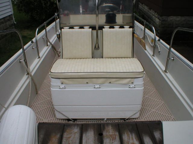

I have had success with fiberglass medium cut compound (3m or Meguiers) and a bristle brush head on a buffer or drill and then Woody Wax. I covered the entire floor with Dri-Dek after it was cleaned and it never got dirty again.
- DeckBow.jpg (42.86 KiB) Viewed 9329 times
