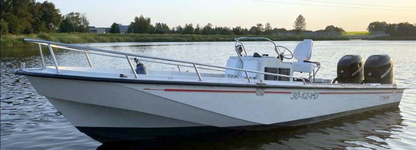

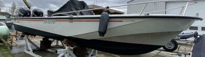

Below are photos of the boat. It is definitely an Outrage 25 without the Whaler Drive. The two Verado engines are on the transom of the boat.
The boat is sold through a broker--but not a very reputable one--and there is something off when you look at the pictures. It just doesn't look right. Also the waterline shows serious signs of leaning back in the water. Not enough buoyancy to support the two beasts.
I will have to pass on this Outrage 25 and see if a better option comes along. Any leads are highly appreciated.
Fig. 1. Afloat
Fig. 2. Stern view
Fig. 3. Stern quarter view
Fig. 4. Bottom paint

There is some irony in this discussion. There have been very few classic-era OUTRAGE hulls re-powered with a six-cylinder VERADO engine, but the one I recall seeing was on an OUTRAGE 25 hull. To see an OUTRAGE 25 with notched transom with two VERADO six-cylinder engines is really quite astonishing. I am surprised the hull could handle all that weight. And I don't think it really does handle it.
Based on Figure 2 and where the bottom paint is applied, the boat's static water line at the transom had about ZERO freeboard.
The general rule for assessing weight on the transom is the location of the engine splash well drains relative to the water line. On the boat seen here, it appears the engine splash well must have ALWAYS been full of water at rest. Perhaps underway the boat gained some freeboard at the transom from the hull lift and propeller lift.
