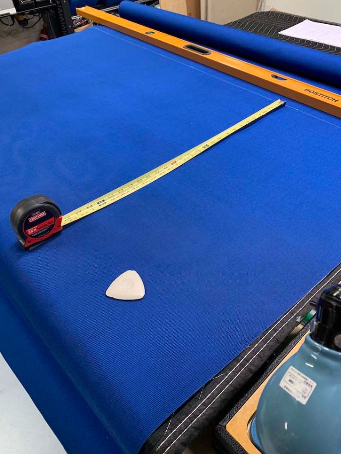

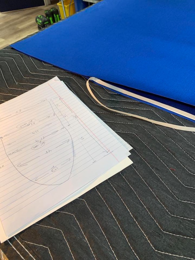

Fig. 1. Cutting the first of three panels, laying across the beam of the boat.

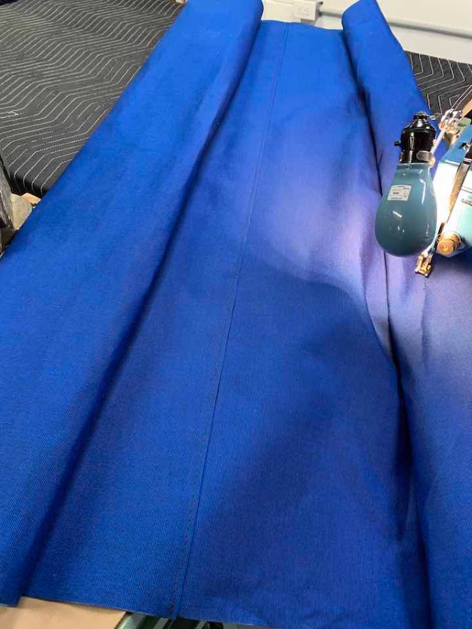

Fig. 2. Using seamstick to attach two panels, prior to sewing.
Fig. 3. The first stitch.

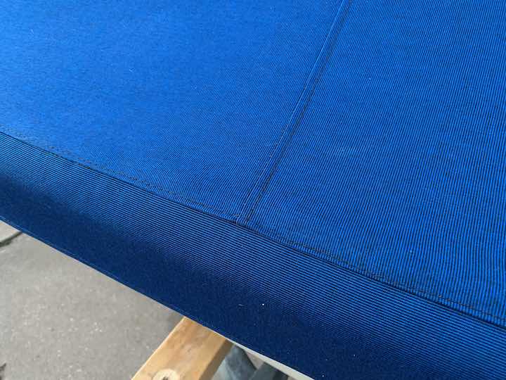

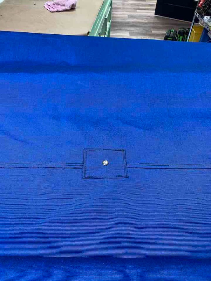

Fig. 4. Semi felled seam.
Reinforced snaps for support poles:
Fig. 5. Reinforced snaps for support poles.

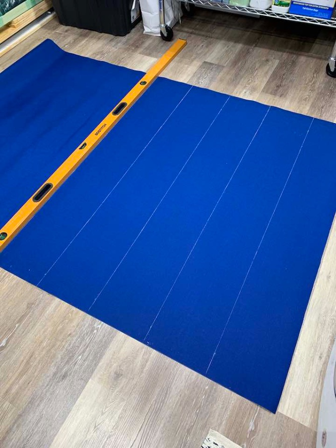

FIg. 8. Cutting strips to make a perimeter skirt.

Fig 10. Detail view of stitching.

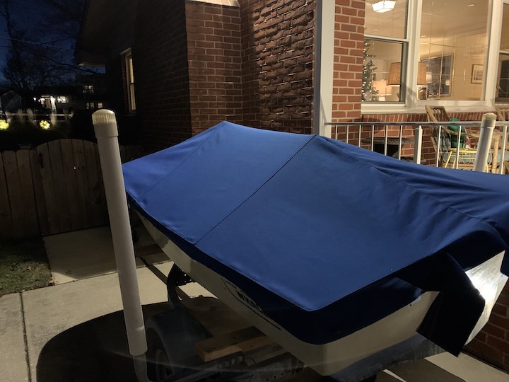

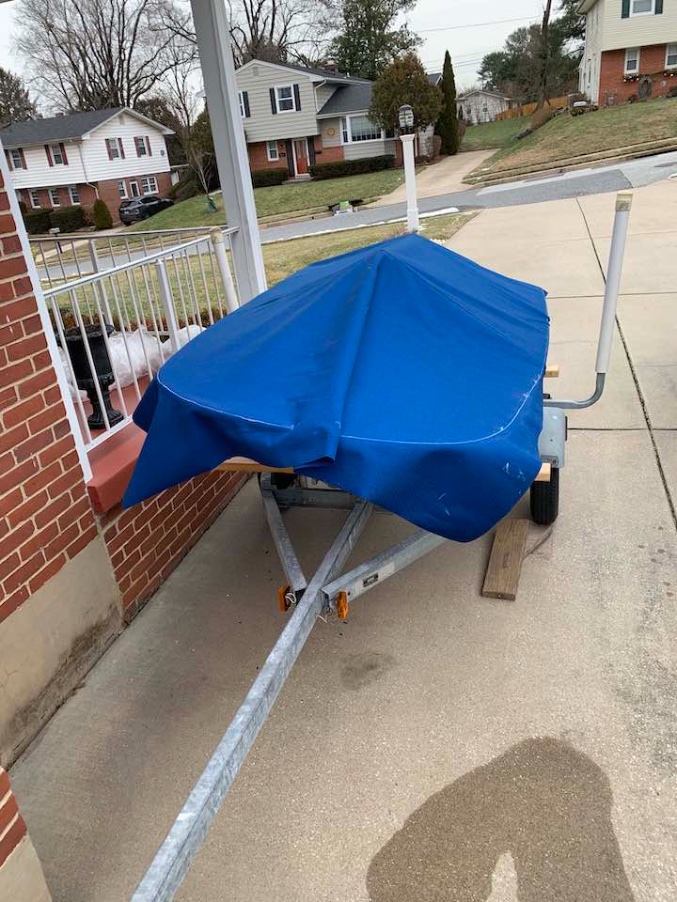

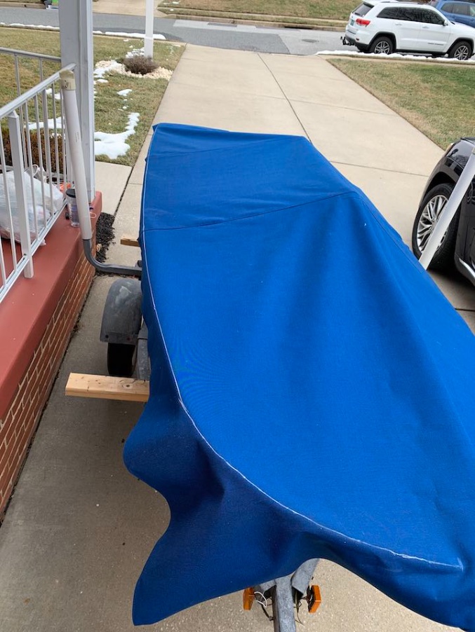

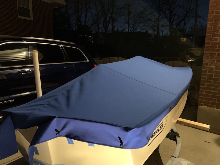

Fig. 11. Installed with temporary snaps (snaps were already on the hull from prior owner but no cover).
Fig. 12. Another view.
