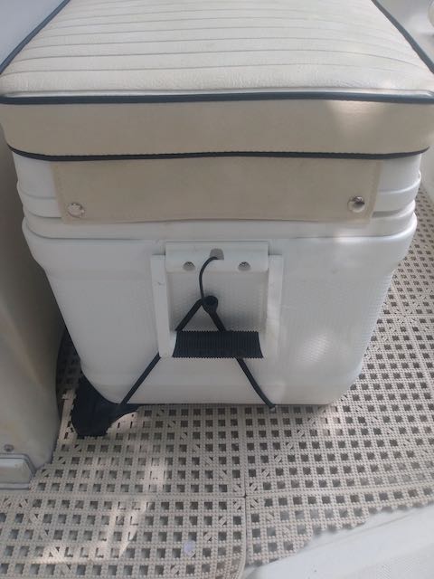

Note the OEM cooler hook offered by Nauset Marine https://www.nausetmarine.com/boston-whaler-parts/coolers/1043181-cooler-hook/ for the bungie does not fit some of the latest Igloo Marine cooler models due a change in the handle assembly.
Threading a single rubber dipped clip into the cord will work as it can be clipped to a hole in the handle assembly.
This post will be amended with a photo showing the described approach.
- Igloo_new_tie_down_method.jpeg (42.07 KiB) Viewed 7981 times
