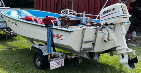

I have a SPORT 13. I want advice about the MODEL YEAR. HIN is BWC1245M84H. The stenciled number is 2C9550
[In some state this boat has been] registered as an 1984, and the HIN confirms that.
The transom is only a 15-inch-height transom, and this makes me doubt the model year is 1985.
The HIN is missing a character that I cannot see.
Fig. 1. The HIN, which appears to read as BWC1245M84H.
Fig. 2. The stencil number, which appears to read 2C9550.
[Inferred question]
Q1: what is the actual model year of this SPORT 13?
Fig. 3. A view of the boat with automobile tires and other crap in the cockpit. The only element in this image that can identify a production epoch is the presence of the sink splash well. For help in dating this hull see the REFERENCE article comments about when the sink splash well appeard.
Fig. 4. A view of the stern showing a notched transom, usually indicative of a 15-inch-shaft height transom. The engine, however, looks like a 20-inch shaft engine.
Fig.5. A side view of the hull which does not help with identification of the model year.

Regarding the transom height appearing to be only 15-inches, this could have been modified by a prior owner. Or, perhaps there was custom order for a short-shaft transom.
Regarding the blue interior color, this also could have been modified by a prior owner. Note that the actual transom in the vicinity of the stenciled number has white gel coat. That would be appropriate for a 1984 model year hull.
Also note in Figure 3 above you can see a white gel coat area around the bow anchor hatch. This is a further indication that the blue color of the deck is not the original gel coat color but is probably a sloppy paint job that is wearing away in areas with a lot of traffic or abrasion.
The portion of the hull that would be most useful in identification of the production epoch is the bow area as seen from head on. Unfortunately none of the images uploaded show any details of the bow area as seen from head on. For more about the change in the bow area of the 13-foot hull read the REFERENCE article (which was linked above) regarding the transition to the smirked-bow which occurred in the 1970's. The sink-style engine splash well also dates the production of the boat to be at least after c.1971.
