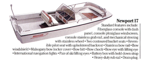

by Phil T
(R)eversible (P)ilot (S)eat.
It is made up of:
molded glass infused plastic "Z" legs
Upholstered seat base
Stainless steel swing arms
Teak swing arm blocks
Teak seatback (framed cushion on Newport)
Stainless steel handles
Recessed PVC rod holders.
From the Whaler catalogs:
Here is the Newport RPS:
Newport RPS
Screen Shot 2022-05-27 at 9.28.42 PM.png (163.82 KiB) Viewed 4042 times

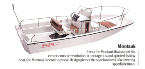

Here is the Montauk RPS. Note the seatback is teak without a cushion.
Montauk 17 RPS
Screen Shot 2022-05-27 at 9.29.19 PM.png (133.24 KiB) Viewed 4042 times
