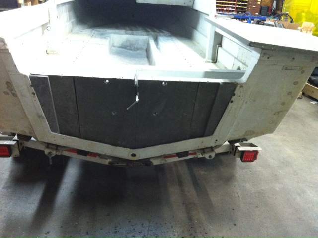

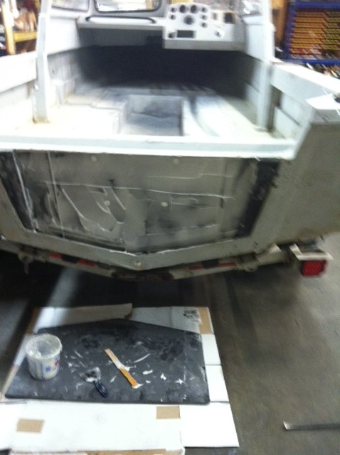

Here is the fit-up of the new transom core material (coosa board) on my 1995 19ft Sentry. I selected 1" thick material because the wood that came out was 2" thick and I want to stagger the seams of the core material. I left a 4" flange around the perimeter of the cutout on the transom so that the flange can be tapered when re-glassing. That flange requires the core material to be fitted in multiple sections but with staggered seams there should be enough strength without a full size sheet. It was also cheaper bringing in 1/3 sheets than a full size sheet anyway.

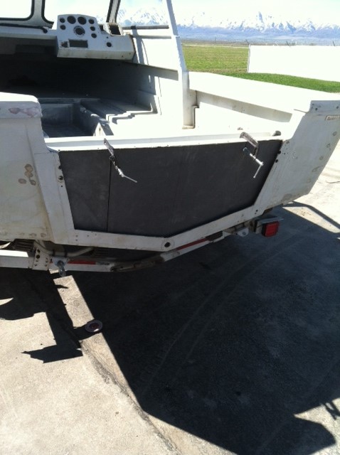

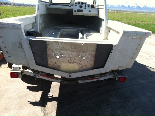

Here are the next layers staggered and then bonded to each other. The outer skin is then bonded on. I vacuum bagged the transom to squeeze the layers together and also used clamps over the bag. Next step is to feather the seam where the skin was cut and reglass that so the original skin strength is restored.
