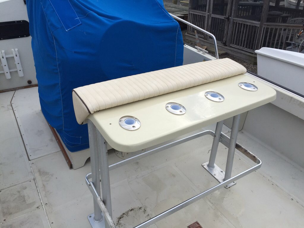

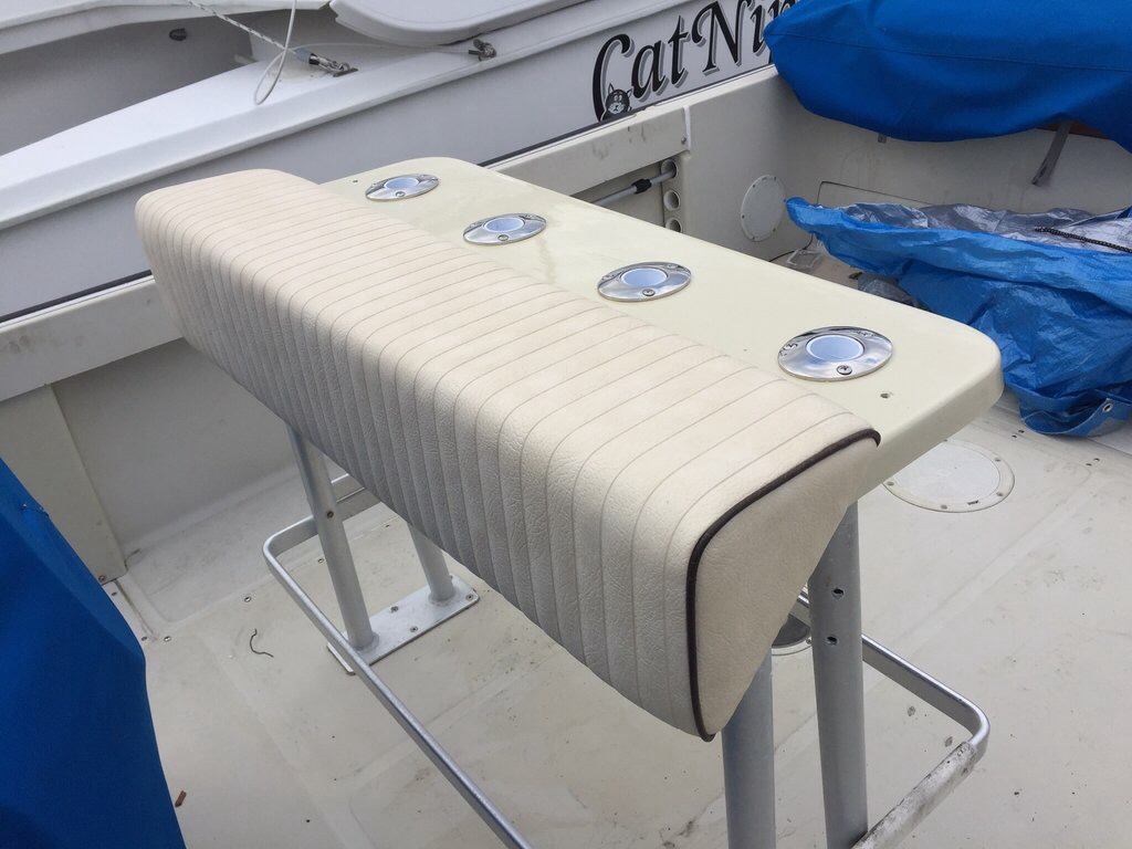

Here's an update. Got the cushion from Anderson Manuf.. Nice work. Expensive, but decent.

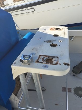

I filled all the holes and gouges with filler bondo, sanded everything down, refilled, re-bondo any dips, resand everything.
I used a low cost single part Topside paint by Rustoleum. $14/quart from Home Depot. It worked OK. Did about 4 coats, with sanding in between. It's not gel coat smooth, but looks good from 3' away. I did notice that it's kind of soft, which means it will mark up easily, but to refinish in a couple years is easy.

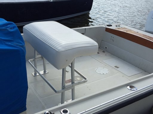

The leaning post was originally a mess. The previous owner put on a huge single cushion, which looked god aweful. It covered the rod holder area too.
So off it came, and what was underneath was terrible.

This is what I found underneath:

Looks nice!
I think you will find the Rustoleum Topsides will harden a bit more over time...mine did. It took about 30 days or so. I refinished the console on my 17' Montauk and it turned out fine.
