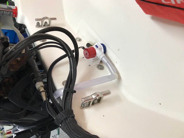

- Added a bilge pump (for when my son forgets to pull the plug when tying up)

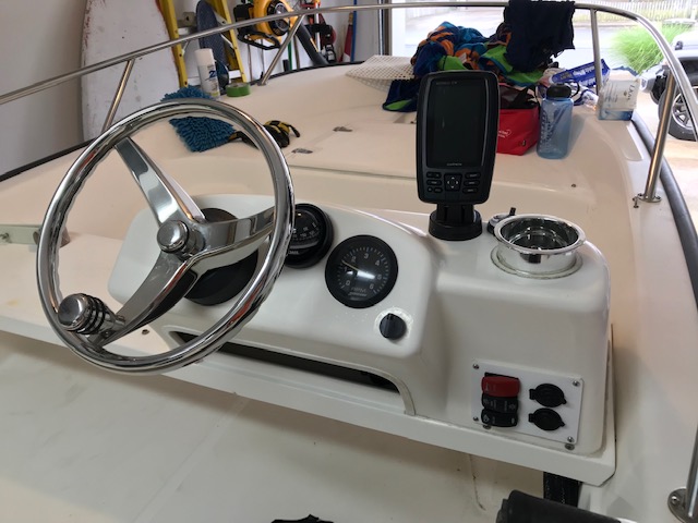

- Added a Garmin Echomap 44cv with transducer (had to relocated the stern light receptacle)
- Added Ritchie Compass
- Swapped out the original black steering wheel for a stainless
- Had a bow rail installed. My wife was concerned about safety. I love the way it turned out.
- Added a New Wire Marine switch panel that has:
- New navigation/anchor light switch
- Horn Switch
- Manual bilge switch for when water breaches over the bow
- USB charging ports
- 12v port

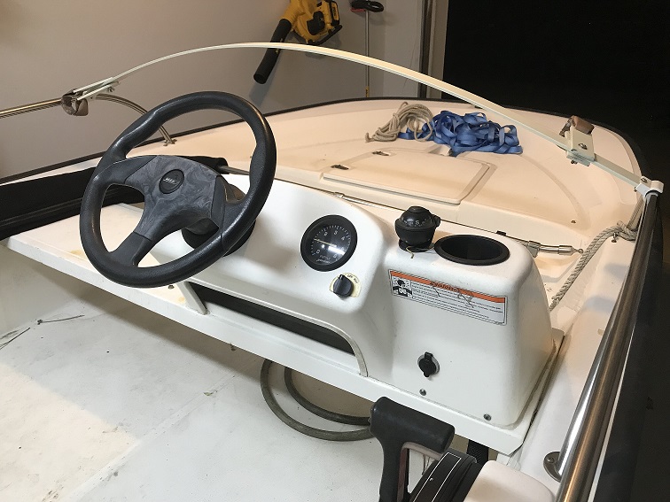

Here are some pictures:
Before pic Console.jpg (149.17 KiB) Viewed 10369 times
130 Bilge Pump.jpg (64.59 KiB) Viewed 10369 times
130 Console II.jpg (84.22 KiB) Viewed 10369 times
