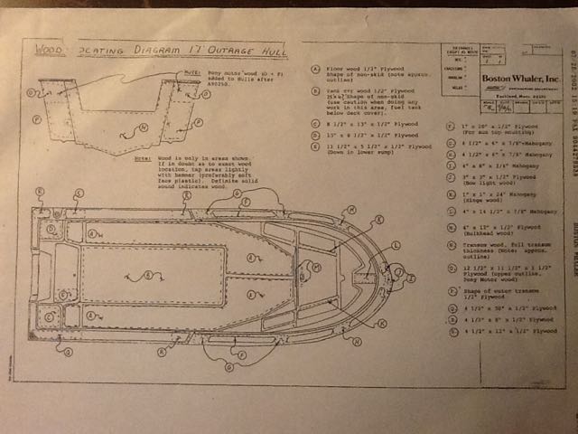

Is there wood in the transom of a 1995 Outrage 17 for mounting a swim platform?
Re: 1995 Outrage 17 Swim Platform
Postby Phil T » Tue Oct 01, 2019 10:20 am
Yes.
My friend Joel was nice enough to share the wood drawing. Attached.
