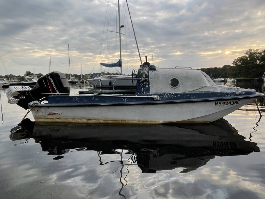

Hello. I am a new member of the Boston Whaler family. I am the proud owner of a Menemsha.
Fig. 1. A MENEMSHA 16.
She is rough looking but has a solid hull and a good engine. I began removing a couple of layers of pealing paint and will be replacing the woodwork over the long cold and dark Massachusetts winter.
She is missing the windshield. I will probably make a replacement as I think finding an original might be impossible.
I am interested in any advice as I begin this project.

Re: Menemsha Refit
Postby Jefecinco » Wed Oct 20, 2021 10:15 am
What is the purpose of the laundry basket? I assume it is a temporary propeller guard to protect boats moored nearby but it appears the skeg remains exposed.

Re: Menemsha Refit
Postby menemshaman » Wed Oct 20, 2021 3:49 pm
Boats were banging into each other while moored so the harbor master ordered that all props be covered.
