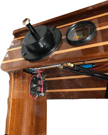

Took the boat for a ride last week and the dead spot in the cable steering drove me nuts and motivated me to start installing the Baystar system.
Fig. 1. Pulled the console and associated wiring and now able to clean up a few things I decided to change.
Fig. 2. Old below and new Baystar cylinder installed, no plumbing yet.
Fig. 3. I used a backmount kit to reduce steering wheel protrusion since the helm pump extends out a good bit.
Fig. 4. Once installed it is the same fit as the cable system it replaces.
Fig. 5. View of the helm. Still need to mount console and tidy up a few things.
Fig. 6. View of helm rotated to normal orientation.
I need to figure out if I can run the hoses in the rigging tube, or if they are too stiff and need to be run another way.

Steering is installed and took it for a ride today and this was a very worthwhile upgrade. The dead spot in the steering is gone and there is zero torque steer in the wheel with a noticeable reduction in steering input. Very pleased with the results.
Steering wheel with the recessed mount kit is the same as the cable teleflex.
I ran the 2 hydraulic lines on the inside where as the cable steering ran on the outside.
The hydraulic lines run through the rigging tube, so there is only one line (the rigging tube) that carries everything to the motor.
The lines in the kit are rigid and cut to length, the unfortunate part is they are not as flexible to make tight bends, so after covering in split loom the engine side of the rigging looks like an octopus, but it's rigged and protected from the UV.
