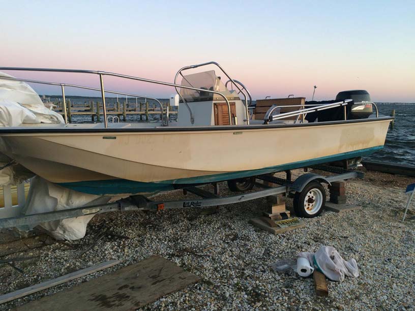

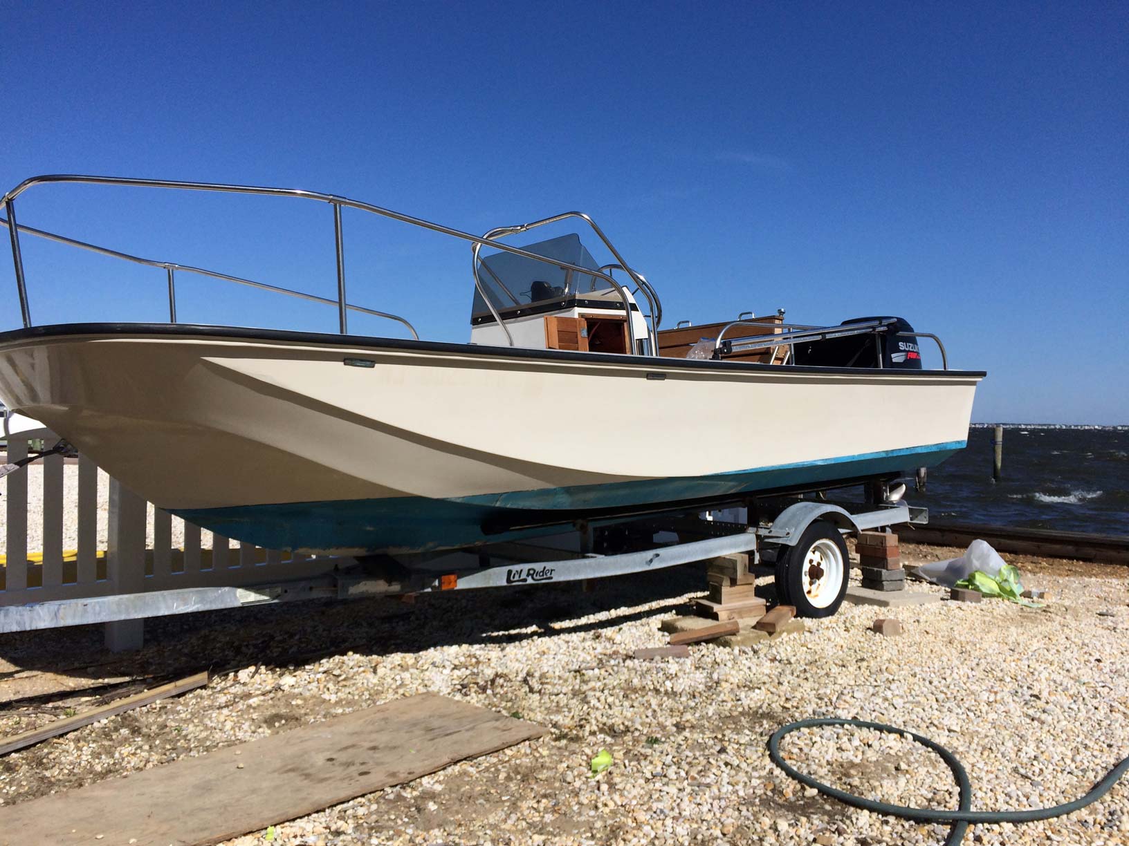

We arrived in New Jersey last Wednesday night and, thanks to jetlag, I was up at 5am on Thursday and started working on the hull.
Below is a short narrative of that work, and pictures that detail the progress.

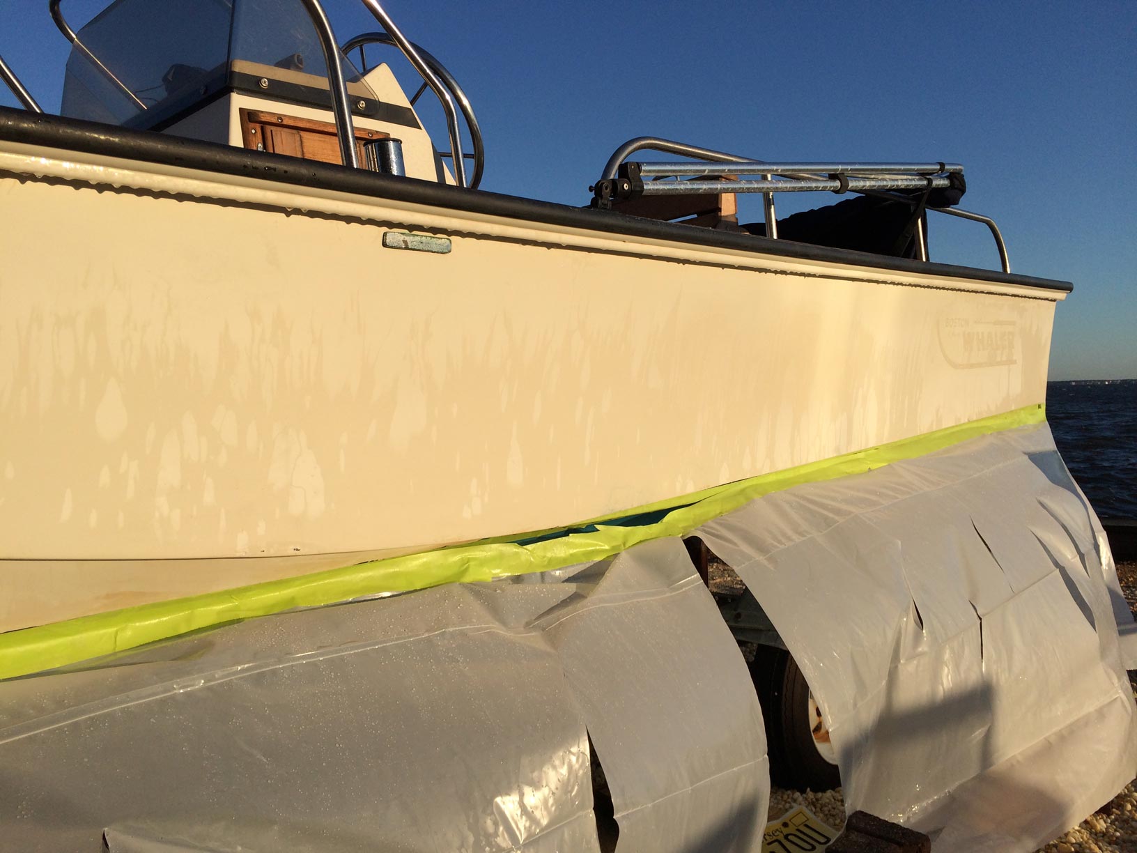

I started with the port side of the boat. My first task was to cover the bottom paint with a strip of plastic sheeting to protect it from the On & Off Hull/Bottom Cleaner that I would first use to clean the hull. This proved to be an annoying step: The wind was blowing hard from the NW, which left me and the boat exposed to the wind, and the green 3M tape that I used to secure the plastic to the top edge of the bottom paint would not hold. I used multiple sections of plastic and cut small semi-circles into the plastic in an attempt allow the wind to pass through. I applied the On & Off with a scrub brush and let it sit for a few minutes as per the instructions. I then hosed off the hull. The On & Off took off the orange discoloration.
After going through the process of taping plastic along the bottom paint edge for the port side, I decided to skip that step for the starboard side. I did so for a few reasons: I needed to sand and repaint the bottom of the boat, so preventing the On & Off from getting onto the bottom paint was not necessary. And the wind was blowing so hard that my attempts to keep the plastic in place where futile. Also, when I started working on the starboard side I applied the On & Off with a sponge instead of a scrub brush. This allowed me to be a bit more deliberate and strategic with the application of the On & Off gel.

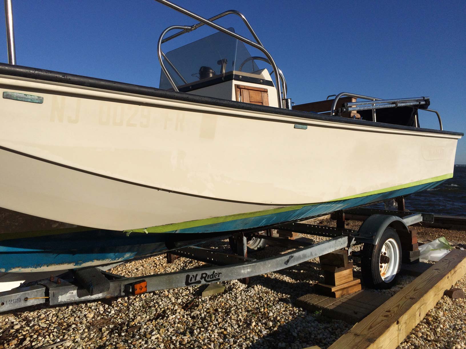

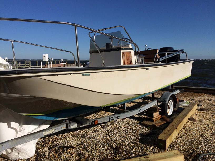

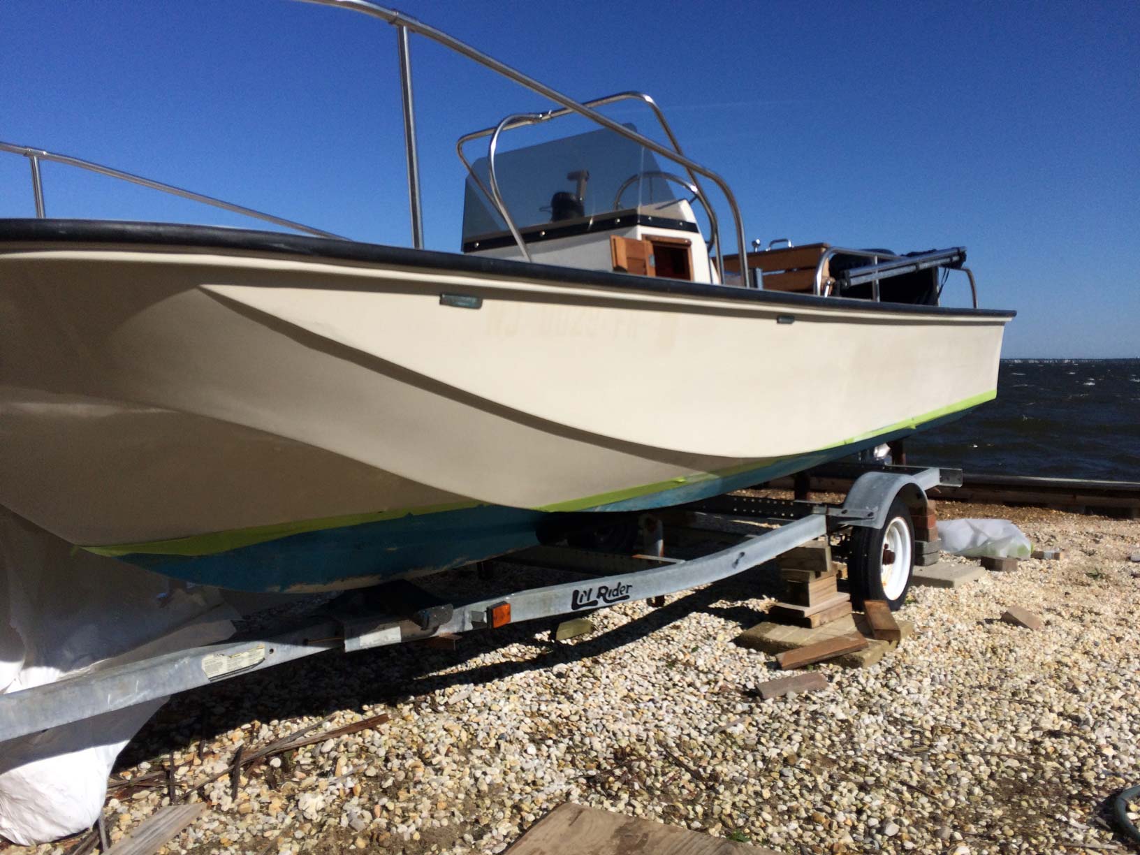

Wet Sanding:
I started wet sanding with the 600 grit paper and then moved to the 1200 grit paper. I put some dish detergent in the bucket along with water and used that to wet the sandpaper and to remove the gel coat dust that accumulated as I sanded.
After wet sanding, I used Presta Gel Coat compound with the buffer and the 3M compounding pad #05711. The 3M #05711 compounding pad didn't fit onto the buffer backing pad as snugly as I would have liked; the compounding pad flew off the backing pad a few times.
Once I finished with the get coat compound I started working the hull over with Presta's Ultra Cutting Creme. For this step I used the 3M polishing pad #05713. This pad fit nicely onto the backing plate of the buffer and did not detach itself from the backing plate the way that the 3M compounding pad #05711 did.
I then used Meguiars #9 Swirl Remover with the 3M polishing pad #05713.

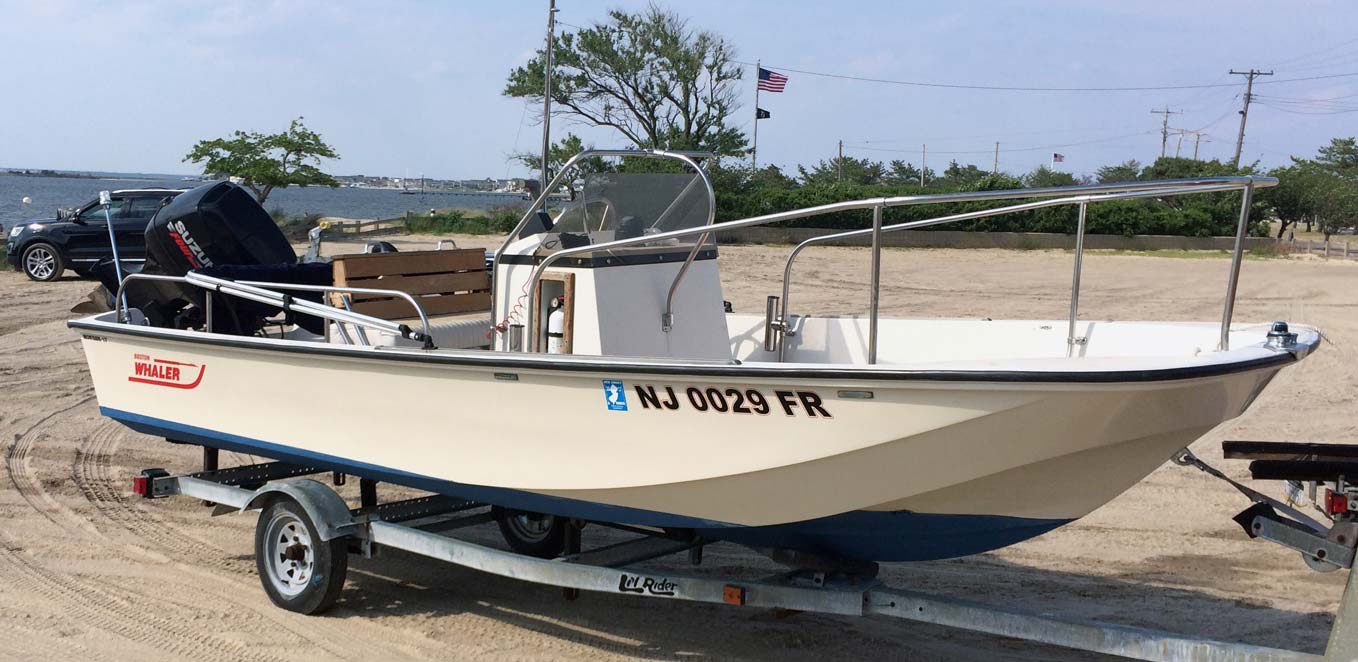

When I finished this last step I was expecting the hull to be glossy with a high shine. I was slightly disappointed to see that the hull was not as glossy as I had hoped. I chalked this up to being a compounding and polishing novice. With that being said, the gel coat looked much better than it did before I started working on it.
It took me close to eight hours to compound, polish, and glaze the entire boat.

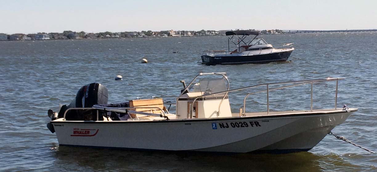

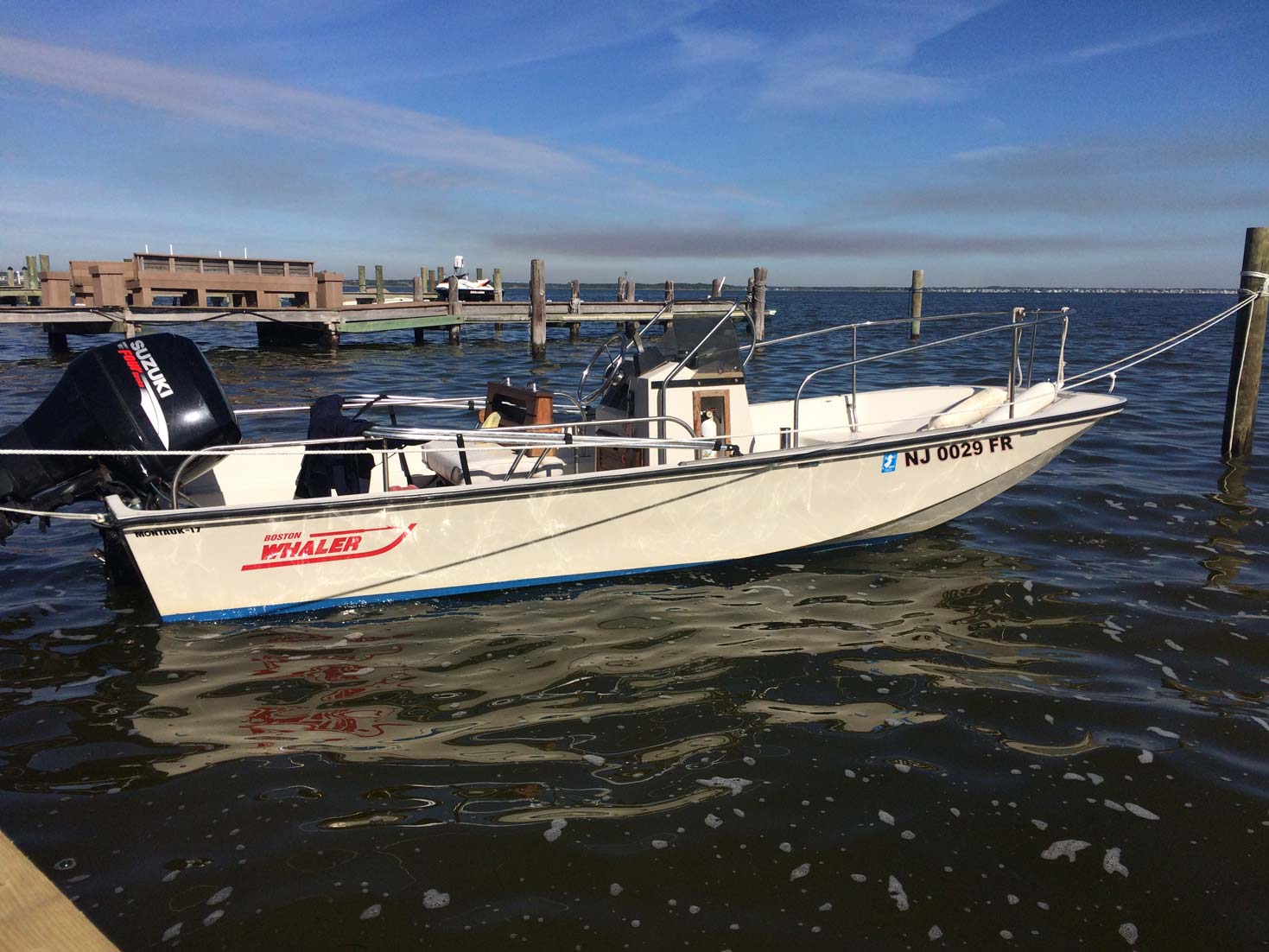

A childhood friend owns a local print shop in Point Pleasant, NJ called Blazing Visuals. I contacted him and asked him to make a new registration decal for the boat. I sent him both the "Boston Whaler" logo and the "Montauk 17" and he designed a few options for the registration decal. I also asked him to print out the "Boston Whaler" and "Montauk 17" decals. He wasn't able to find the same Boston Whaler logo that I had on the boat, so we used an updated version.
After the decals were installed I applied the Collinite #855 Fleet Wax. I applied two coats to the hull, and additional coat along the water line. My initial disappointment in the glossiness of the gel coat dissipated once I finished applying the wax and then buffing the hull. The hull shines and I am very happy with the results.
The images below, and in the next two posts, show a progression of the work that I completed.
