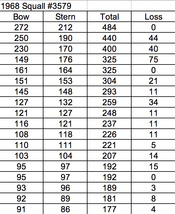

Postby jimp » Sat Jun 16, 2018 8:47 pm
This might take a bit longer.
Screen Shot 2018-06-16 at 4.46.22 PM.png (211.82 KiB) Viewed 7680 times

Postby jimp » Mon Jun 18, 2018 10:36 am
Adding dates would be better.
Bow Stern Total Loss
04/01/02 272 212 484 0
08/01/02 250 190 440 44
06/01/03 230 170 400 40
04/25/04 149 176 325 75
05/02/05 161 164 325 0
05/29/06 151 153 304 21
06/23/07 145 148 293 11
06/15/08 127 132 259 34
07/05/09 121 127 248 11
06/12/10 116 121 237 11
06/11/11 108 118 226 11
06/26/12 110 111 221 5
07/07/13 103 104 207 14
07/13/14 95 97 192 15
06/20/15 95 97 192 0
06/11/16 93 96 189 3
06/25/17 92 89 181 8
06/16/18 91 86 177 4

Drying foam is a very slow process and you'll never get to 100% dry. As I've heard from many people that repair Whalers, "there's no such thing as a dry hull once it's been in the water." That might be extreme, but the foam in most boats does seem to wick up water and hold it. I've seen Whaler projects where they cut hold and remove the foam and then pour in new foam.
I would try building a sealed enclosure for the boat and run a dehumidifier to see if the process can be accelerated.
