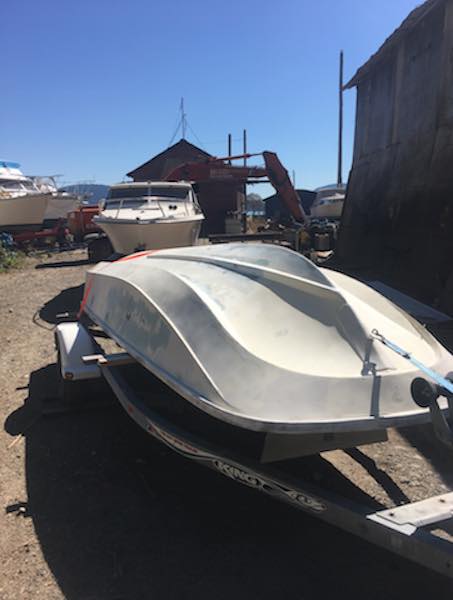

Finally started the 1989 17-foot Boston Whaler restoration project,
Hull stripped and flipped
- hull_repair.jpg (36.65 KiB) Viewed 5353 times

I don't think I've seen the running surface of a 17-foot hull from this perspective before:
This view shows some angles on the hull that are quite interesting.

Restoring the chines has been some work. During the hull sanding, it became very obvious that this classic had seen some rough docking and beaching. The chines have taken some serious time to make almost perfect, and I have yet to have them where they need to be. The distinctive chine lines of this hull need to be retained. Once it is painted, I don't want to see wandering hull chine lines.
