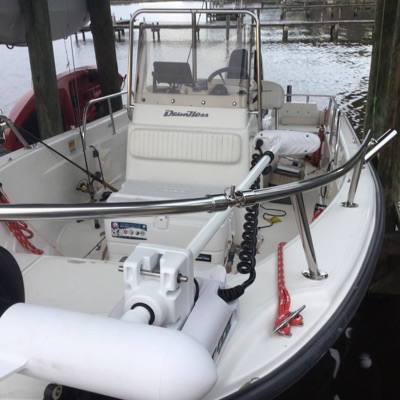

I originally bought a Minn Kota 55 lbs. thrust but it was not enough for my 16' Dauntless so I went to a 24v 80 lbs. and love it. Here are some pictures of my installation

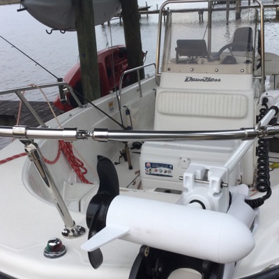

Postby Cad » Sun Jan 03, 2016 7:18 pm
Another pic

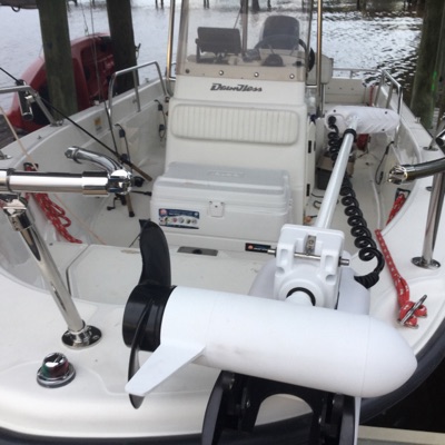

Postby Cad » Sun Jan 03, 2016 7:21 pm
Another pic

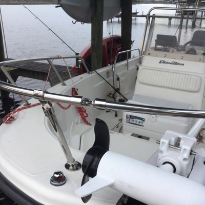

Postby Cad » Sun Jan 03, 2016 7:24 pm
One more pick
