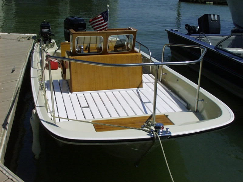

I know a project like the one I have in mind is challenging, but that's kinda why I like the idea.
I know some Whaler 16's had the flat deck but it's not really what I'm looking for. I've posted a picture of a Wahoo 17 or 18.5 that shows what' i'd like to do. I think [Boston Whaler] used this design for the Montauk 170.

Re: Thoughts on a Montauk 170 inspired restomod
Posted: Sun Nov 20, 2016 7:39 pm
by Jefecinco
I believe it's much more likely Wahoo used the Montauk design for its copy than that Boston Whaler copied a Wahoo design.
