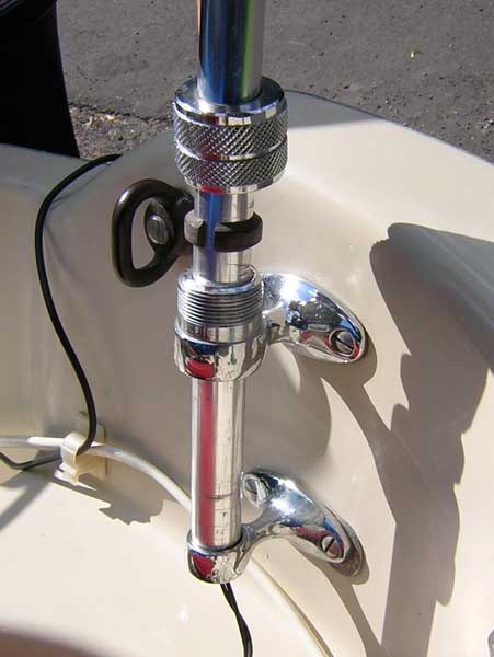

I think [my 1985 Boston Whaler SUPER SPORT 15 boat's white all-round navigation lamp mount is] missing a piece that fits in between the top threaded mount and the knurled piece that screws down upon it. I just ordered a new [white all-round lamp fixture]. When I tighten-down the knurled piece the lamp pole can still move freely. [Is the mount] missing a compression fitting of some sort for this?

On the typical mounting on the transom of a classic Boston Whaler 15-foot boat for the white all-round lamp pole, there is a knurled threaded ring fitting that compresses an insert into the upper mounting bracket. If this insert is lost, there won't be any compression. On my 1976 boat the insert was a circular ring or spacer with a bevel and a slot cut into it so it was not a complete circle. This was compressed by the knurled ring being tightened. This detail is clearly shown in the image below:
Boston Whaler pole lamp compression fitting showing internal compression ring

As for exactly where you could find a replacement part, I cannot offer any sure source. The general design of this fitting is very similar to what was used on adjustable microphone stands. You might be able to get a similar compression ring from a vendor that sells a lot of microphone stands, perhaps something like GUITAR CENTER.
It is a long shot, but perhaps give Boston Whaler customer service a call, or the renowned parts dealer Twin Cities Marine.
You could also fabricate something like this from wood by using two hole saws to cut the ring-shape, sanding on the bevel, and cutting the slot.

Thanks for the reply, that's exactly what I need to know. Amanda at Specialty Marine offered to send one to me for free so they apparently stock that part.

The rubber piece was missing from my [lamp] also. I used a garden hose gasket in its place. Just cut it so it fits around the mast, slip it on, and tighten, and you are good.
