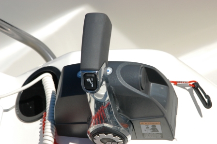

I recall seeing a photo where the owner mounted the [top-mount remote control unit] on the console so the overhang was on the top of the face and not below.

As suggested above by Phil, a workable solution is to let the overhand occur on the upper edge of the mounting pad, and fashion a new escutcheon plate so the base of the controls won't be left in mid-air.

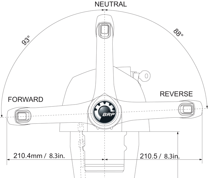

On further investigation, perhaps the problem is the distance needed for the throttle lever to move forward. At complete extension of the throttle lever forward, the lever is going to need about 8-1/2-inch clearance. See the drawing below:
Is this the actual problem with space available on the console?

This is similar to my 170 [helm console] and [E-TEC remote control] throttle base. There was not enough room between curves and edges without this adjustment. KING StarBoard of 1/4-inch thickness was used to lift the throttle and fair the mounting. It looks good.
