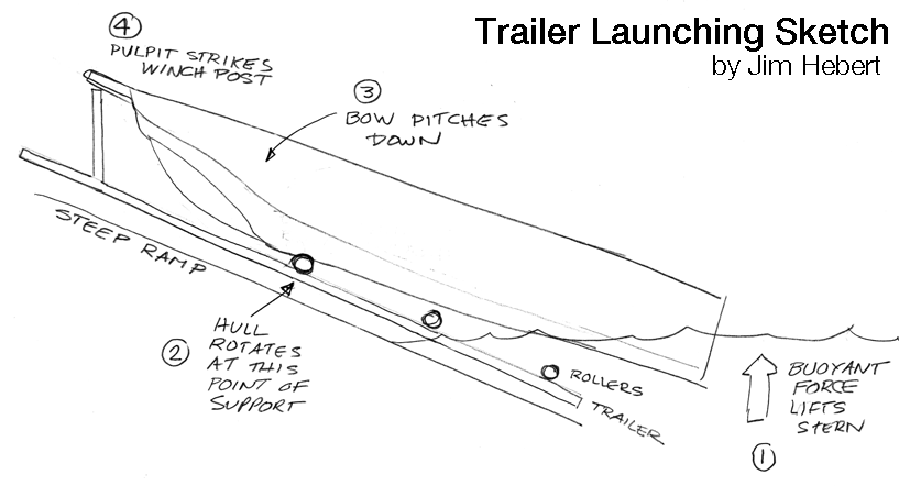

Here is a sketch illustrating the problem:
--(1) as the boat is immersed in the water, the stern gains buoyancy, lifting it off the trailer
--(2) the hull remains in contact with the trailer supports, but only at the forward end
--(3) the result is the hull rotates, pushing the bow downward
--(4) if there is no support to resist this movement, the bow comes down and the pulpit strikes the winch post.
This problem can be overcome by two approaches:
--don't back the trailer as deeply into the water; this reduces the buoyant force at the stern; with a bunk support trailer the hull may not want to slide off yet; experiment to find the optimum amount of immersion.
--add a roller or support close to the bow stem to keep if from dropping; an extra roller or support close to the bow will keep the bow from rotating downward.

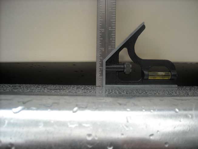

by jimh
Another consideration for the set-up of a trailer with a Boston Whaler boat is the clearance between the trailer fender and the hull chines. The lower the hull can be set onto the trailer the better in all aspects. Lower boat height on the trailer leads to:
--lower center of gravity of the boat and trailer, which improves stability on the highway when towing;
--faster buoyancy of the hull as the trailer is immersed, which makes launching and loading easier if the ramp water depth is limited; and,
--easier entry into the boat cockpit when the boat is on the trailer.
The standard boat trailer has a maximum width of 102-inches or less, due to a need to comply with maximum width for highway travel without needing an over-wide permit. The trailer fenders typically project inboard at least six inches. This gives a maximum width at the fenders of not more than 90-inches or perhaps less. The result is most Boston Whaler boats of 18-feet length or more will have a beam that is wider than the space between the trailer fenders. The outcome these physical limits means the chine-line of the hull will have to sit atop the fenders.
The closer the hull chine-line can sit to the top of the fenders, the better the outcome (for the reasons mentioned above). A few years ago I re-worked my trailer set-up to lower the boat's position on the trailer by about 1.5-inch. This modification was done while the trailer was getting new fenders installed. The outcome was very good. The clearance of the chine line to the fender top is now about 1.25-inches, as illustrated in the image below:
The hull chine-line clears the trailer fender by 1.25-inches.
I have seen other Boston Whaler trailer set-ups with even less clearance. Don McIntyre's OUTRAGE 21 and trailer have the least clearance I have seen; only about 0.5-inch (or less) separates the hull chine line from the trailer's fender on that rig.

First launch went rather smooth. Pulpit and anchor cleared the post with room to spare. Recovery went pretty quick as well, especially since I didn't get to move the trailer, couldn't get the boat started.
Primer bulb would get hard, then soft. Then I smelled gas, and saw gas leaking from the bowl.
Gave the plastic bowl on the filter a twist and it came off in my hand!
I carry a spare filter, but didn't have the filter wrench - so, back on the trailer and home to change the filter and clean up the gas.
Back to the ramp. This time I put the trailer in a little deeper to see how it affected the launch. Couldn't clear the winch with the anchor in the davit. Recovery went smooth, the electric winch is a very nice upgrade.
The video is from the first launch.
On the second launch I used a snap shackle and 10-foot line on the winch strap to bow eye to make removal a little easier. I'm going to improve on that. I'm thinking of using a short line from the bow eye to winch strap, just shorter then the distance between the eye and the winch while in transport position.
http://www.youtube.com/watch?v=-AF4aIp_pBg
I'll be using Jim's suggestion as well, just barely floating the stern and see how it goes.

jimh wrote:...clearance of the chine line to the fender top is now about 1.25-inches...
[My trailer has] about the same clearance.
