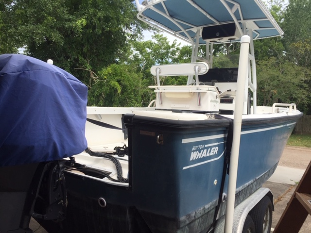

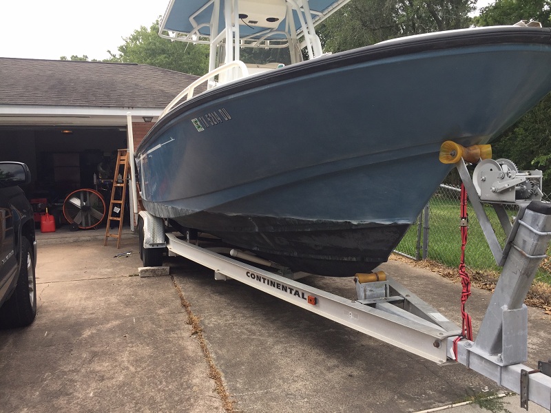

I have not been able to find any information at all about the 24 Outrage Limited Edition from the mid 1990's. It would be nice to find out more information. I really don't think there is anything different about my boat. Here are a few things that my boat has:
--low profile bow rails with white powder coating instead of the high rails
--a gray-blue gelcoat which has not held up very well in the sun; it is gelcoat not paint and it is the whole boat hull that is blue
--no bottom paint
--deck is two-tone, gray on the the non-skid and white everywhere else
--fresh water tank under the front deck
--original "Limited" decal on the side of the leaning post and maybe somewhere else on the boat.
I really don't have better pictures than these:
Fig. 1. No caption
image2 (1) smaller.jpg (188.48 KiB) Viewed 11327 times
Fig. 2 No caption
image1 (17).jpeg (125.22 KiB) Viewed 11327 times

This particular 1994 OUTRAGE 24 boat is indeed special. I never saw or heard about blue gelcoat Boston Whaler hulls back in c.1994. Like everybody else, I know about those few boat show teal hull color 24 Outrage boats.
The only thing that comes to mind is that boat was made for [a Boston Whaler] executive or retiring employee . I read a story about a blue gelcoat 21 Conquest that was owned by Boston Whaler executive; maybe this boat has similar path. Either way, your boat is a gem and looks very cool since it is one a million--as they say.
That two-tone gray-white deck option was very, very expensive. I had a 27 Offshore; if I remember, even back in 1991 that [option] was a few thousand dollars. It is a cool option. I always admired the craftsmanship of laying out two tones while building [an OUTRAGE 24].
Looking at entire package, don't even think about removing the T-Top. It would be a crime to separate [the T-Top] from this gorgeous boat.

In Fig. 1 above you can really see the nice bow entry of the c.1994 24 OUTRAGE hull. It should be able to slice into head seas.
Also seen in Fig. 1 is the nice fit on the trailer. The hull chines look like they are riding just an inch or less above the trailer fenders. That is a good fit for the the boat on the trailer.
