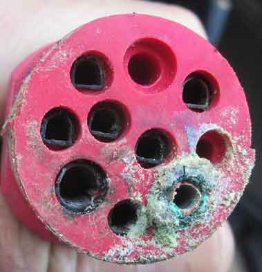

Pictures of that red connector at the back of the powerhead indicate an open circuit due to excessive corrosion.
https://scontent-iad3-1.xx.fbcdn.net/v/ ... e=5A6A281D
https://scontent-iad3-1.xx.fbcdn.net/v/ ... e=5A7A1D42
Can these connections be "pushed out," cleaned and/or replaced individually or do I have to replace the entire thing?
What are these type of male connectors called?
Not so proficient in electrical stuff even though I took (2) semester of physics in college.
P.S. I think it's time for a complete look at all the similar "connections" in the engine loom so I can be confident that I don't have to turn into a "mechanic on the water." I don't understand why these connectors are not protected by dielectric grease?
Bob

Red plug culprit. This should be an annual maint item to disconnect, inspect and put corrosion block on the pins.
That plug is part of the harness and if it were my motor, I would clean up what is left and continue using that plug. I would also tap into the missing pin where the wires go into the plug and install a male/female jumper around it (simply bypass for that circuit). That's the simplest repair short of replacement.
Or buy a used one. https://www.ebay.com/itm/1992-1996-Johnson-Evinrude-Motor-Cable-Wiring-Harness-584401-50-60-65-70-HP-/362050194268?epid=1022082438&hash=item544bdf8b5c:g:NJQAAOSwiX5Zd6Y5&vxp=mtr
You can clean the plug with CocaCola (it contains phosphoric acid) and a toothbrush.
D-

The plug is a means of connecting the main wiring harness from the control box and ignition to the motor and plugs are widely used by nearly all the outboards made to speed rigging time and allow for disconnecting for troubleshooting. Yes, one could simply remove the plug and use mechanical crimps or solder, but soldering wire is frowned up in marine setting, especially where vibration is present.
The Evinrude plug is reliable, just needs to be cleaned and maintained, which is tends to become an overlooked item. The worst design was by Merc on the 70 - 80 inline 4 and 6 cylinder motors where a similar type plug was used and it connected at he lower cowling of the motor and was constantly getting water spray. Those had lots of problems.
D-

I cleaned-up the connector plug, installed a NEW male connector and cleaned-up the existing female. Still sounding alarm/horn continuously. WTF?!!!

I removed/pushed-out the individual wire from the male-side of the plug, as all the wires are in plain view. However, the female part is configured like a regular "house" wire; no wires showing but just a black sheath. I would have to slice that with a razor knife in order to get the other wire out. Is that what should do? Rig the workaround wire, tape the rest up and leave it alone before reconnecting everything to test the horn problem?
Bob

I would hardwire that circuit around the plug.
Once you start hacking the red plug with a razor blade you might as well abandon the whole plug.
D-

I know but I have to cut the one side in order to see where the female wire end is. There's no other option in order to get the wire out.

OK, you didn't cut the connector like I was thinking and it's still good. You could also do the same to the other side and then take an ohm meter and testing each leg of the connector.

BINGO! Low oil sensor going up to (or coming from) the reservoir.
https://scontent-iad3-1.xx.fbcdn.net/v/ ... e=5A695067
According to my mechanic at the local boat yard, he says this is some sort of engineering defect and in order to fix it, I have to purchase the entire unit. He told me not to worry about it, as long as I keep the tank full with oil (which I always do), it won't be a problem.
What do I do about the electrical/sensor connection though?
Process of elimination described by Jim worked like a charm, i.e., once I was able to find the wiring connectors.
Not bad for a beginner right? I still can't believe that the big red plug wasn't involved. Hard to believe with that corrosion level, especially on the one circuit.

If you found that disconnecting the LOW OIL SENSOR circuit shut off the CONTINUOUS ALERT TONE, then the sensor must be defective. The low oil sensor is NEVER supposed to produce a continuous alert tone; it is supposed to beep once every 20-seconds.
The low oil level sensor is not a simple switch. When the float in the tank reaches the alarm threshold, the sensor is supposed to produced a momentary closure of the TAN wire to ground, every 20 seconds. The sensor has some simple electronics to turn the continuous closure of the float switch into a momentary closure on the alarm TAN conductor. This means you can't just fix something mechanical about the float switch; you have to replace the sensor assembly to repair the bad electronics it contains.
Re: 1996 Evinrude 70 hp: Alarm Horn
Posted: Sat Oct 21, 2017 6:29 am
by InVision
Similarly, on our 190 Nantucket we would get a warning of four-BEEPS every two minutes from the Mercury OPTI 150. I had to replace the engine oil tank because the magnetic float broke in the sealed tank.
DISCUS' should be very concerned about the red [Amphenol multi-pole] plug. If a wire in the plug is not making contact you might not get a warning signal that might alert you to a serious situation on your motor.
Posted: Sat Oct 21, 2017 9:56 am
by jimh
Regarding how to improve the connections in an electrical connector like the large, circular, red, rubber-body Amphenol multi-pole connector used by Evinrude on their engine electrical harnesses to connect to the remote controls until the introduction of the MWS system in c.1996:
The mating of these large rubber body connectors will be made much easier if you apply some alcohol to the rubber bodies of the two connectors. Wetting the rubber slightly with alcohol will allow the connectors to be mated with much less difficulty than if both are dry, and the alcohol evaporates away a few moments later. Do not use alcohol that is diluted in water; looking for isopropyl (rubbing) alcohol that is at least 70-percent alcohol.
Also, I would NEVER use a carbonated soda beverage as a contact cleaner for electrical contacts, except as a last resort in an emergency. The electrical contacts in the Evinrude Amphenol connector are silver-plated. You should be able to restore good conductivity to them by using a spray application of WD40, wetting the contacts, then shaking off the excess WD40. The engine shut-off circuit for the safety lanyard switch is one of the conductors in this contact; this circuit carries several hundred volts, so do not energize the circuit when the contacts are still wet with WD40. You just want a film of WD40 on the actual contact surfaces, not puddles of it in the connector housing. In a case of extreme corrosion of the electrical contacts, I would attempt to burnish the surfaces of the male contacts (pins) by careful wet-sanding with WD40 and extremely fine emery cloth.
Do not apply gobs of grease sold as dielectric grease to the contacts or the connector body. The connector body will make its own tight seal, rubber on rubber, and does not need grease. Use alcohol as I described above to help mate the connector. Please note that dielectric grease is an excellent insulator; it has no conductivity. It cannot improve electrical current flow. It should never be applied to any electrical contact. Dielectric grease is only used with some connectors as a lubricant and sealant for the connector body surfaces that have to contact other connector body surfaces. A very thin coating of grease is sometimes recommended for certain connectors. It should not be applied directly to any electrical contacts.
In the case of the connector shown in linked images (above), that connector shows a greenish-blue corrosion that is typical for oxidized copper. The connector is in bad condition. It appears that there is a male contact missing.
The individual contacts in the connector body can be removed. They load into the connector body from the rear. Generally a specialized small tool is used to aid in removal of such contacts. The tool can take the form of a circular tube that is pushed over the male contact, into the body of the connector, where it pushed down on the latching spring of the contact, allowing the contact to be pulled out from the rear. Check with an older OMC dealer for advice on how to service the connector.
It is also possible to eliminate the connector completely, and just fashion your own interconnection for the circuits involved. You could use something as simple as single-conductor connectors to connect the several circuits individually to their appropriate other circuit. For example, you could use something like the ones seen at this resource:
http://www.cycleterminal.com/bullet-connectors.html
Or, you could buy all new terminals for the Amphenol connector, and recreate the original connector. I don't know of an aftermarket source for those connector parts. Check with your OMC dealer to see if the parts are still available from Evinrude. Or you might find an old engine that has been scrapped for parts and harvest its electrical harness.
I illustrate the large circular red rubber-body Amphenol connector in an article in REFERENCE that discusses ignition switch wiring. Here is the illustration from that article:

InVision wrote:DISCUS' should be very concerned about the red [Amphenol multi-pole] plug. If a wire in the plug is not making contact you might not get a warning signal that might alert you to a serious situation on your motor.
I cleaned the big, red plug up with PB Blaster (which pretty much dissolved the corrosion) along with a wire brush, followed by "rinsing" with Brake Cleaner to dry things up. I only had one circuit which was determined to be defective post-cleaning: the male contact had corroded to the point where it had broken off inside the female receptor, but I was able to remove it. That was the red wire with violet stripe. I pushed the lead back out of the plug, reinstalled a new male end, and persuaded it back into the plug in its original position. I added some dielectric grease inside of the plug (i.e., on the female side, as well as along the point where they join together to prevent saltwater intrusion).
The other sensors, the no oil and water temperature, turned out to be fine in terms of the testing protocol defined by Jim.

Here are the BEFORE pictures:
DId you take any AFTER pictures?

jimh wrote:Do not apply gobs of grease sold as dielectric grease to the contacts or the connector body. The connector body will make its own tight seal, rubber on rubber, and does not need grease. Use alcohol as I described above to help mate the connector. Please note that dielectric grease is an excellent insulator; it has no conductivity. It cannot improve electrical current flow. It should never be applied to any electrical contact. Dielectric grease is only used with some connectors as a lubricant and sealant for the connector body surfaces that have to contact other connector body surfaces. A very thin coating of grease is sometimes recommended for certain connectors. It should not be applied directly to any electrical contacts.
I've always applied a small "dab" of dielectric grease to electrical connections in order to prevent corrosion and have never had any problems. Are you suggesting that I re-clean the Amphenol plug (i.e., to remove the dielectric grease) and re-install? Everything appears to be operating correctly now.
Reason for asking is if the connector body makes it's own seal, then this kind of contradicts the evidence as noted by the photographs (i.e., oxidative corrosion) right?

In the case of a 21-year-old rubber-body connection, a bit of dielectric grease might be helpful in sealing the connector so water cannot get into the interior contacts. After 21-years perhaps the rubber has taken a set or is not as pliable as when it was first made in 1996. I don't have a problem with dielectric grease as a lubricant and sealant for the connector's non-conductive elements. The grease does nothing to help CONDUCT electricity. In fact, the grease is about the best INSULATOR you can get and that is what it is designed to do: prevent electrical current from flowing. No one ever puts dielectric grease on the electrical contacts where current is supposed to flow--except boaters who read advice from other boaters. Grease prevents flow of current. That is its mission: stop the flow of current.
Posted: Sun Oct 22, 2017 9:56 am
by thediscusthrower
jimh wrote:In the case of a 21-year-old rubber-body connection, a bit of dielectric grease might be helpful in sealing the connector so water cannot get into the interior contacts. After 21-years perhaps the rubber has taken a set or is not as pliable as when it was first made in 1996. I don't have a problem with dielectric grease as a lubricant and sealant for the connector's non-conductive elements. The grease does nothing to help CONDUCT electricity. In fact, the grease is about the best INSULATOR you can get and that is what it is designed to do: prevent electrical current from flowing. No one ever puts dielectric grease on the electrical contacts where current is supposed to flow--except boaters who read advice from other boaters. Grease prevents flow of current. That is its mission: stop the flow of current.
Actually, it's remarkably pliable for its age. Surprised me too.
So what you are saying [Jim] is to basically clean-up and mate your metal-to-metal electrical connection, then place the dielectric grease on the surface of that connection (e.g., battery terminal) OR in the case of a connective device (e.g., the big red plug) around the rim where the two pieces join together to prevent saltwater intrusion and INSULATE it, and others, from future corrosion? In that way, you maximize the electrical connection on a clean, contact(s) surface AND protect from future corrosion via the dielectric grease.
P.S. I will heed your advise and pull the plug apart and remove the dielectric grease from the terminals as suggested.

The boating-electricity-theorists who recommend smearing INSULATING dielectric grease directly on conductive electrical contacts used on boats have a theory that the INSULATING grease is completely wiped away when the contacts mate, and the INSULATING grease has no effect on the electrical resistance of the contacts. It's a good theory, but I prefer to go with mating electrical contacts that are clean, dry, and free from any residue of anything. I don't think the grease is completely removed. I know how hard grease can be to get off my hands. Why would grease just come off a rather small electrical contact so much easier?
I think the boating-electricity-theorists are confused by the use of a CONDUCTIVE paste that is very often used when making electrical contacts, particularly when one of the conductors is made from aluminum. For many decades a CONDUCTIVE paste made by the Burndy Electrical company and called Penetrox-A has been in widespread use with aluminum conductors to improved the long-term conductivity of aluminum-to-aluminum and aluminum-to-other metal contacts. This is because aluminum oxide is generally a poor conductor, and using a conductive paste keeps air away from the aluminum.
In modern electrical connectors, the actual contacts are usually made from materials like copper, tin, silver, or gold, and aluminum is never used as a contact material. Copper Oxide is not a conductor, so when a copper conductor comes in contact with air or water, the result is formation of copper oxide that does not conduct. Tinning of copper wire is done to prevent formation of copper oxides.
Silver oxide is a conductor, and that is why many contacts are made with silver instead of copper. Even if silver oxidizes it is still conductive.
Gold does not oxidize.
It is quite common to see advice from MANUFACTURERS of marine products with electrical connectors that suggests a thin coating of dielectric grease should be applied to the seal material of the body of an electrical connector. The advice is often accompanied by advice to NOT apply the grease to the actual contacts.
